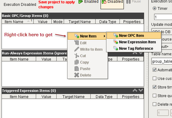

  1. In the Designer, go to Project Browser, and click on Transaction Groups. The workspace now changes to the Transaction Group workspace.
  2. Right-click on Transaction Group to create a New Transaction Group, or click on a group you have previously created. You will now see the workspace changes to look like:
  3. Right-click in the white area, and choose New Item > New OPC Item.
    The Edit group tag window is displayed as follows:
