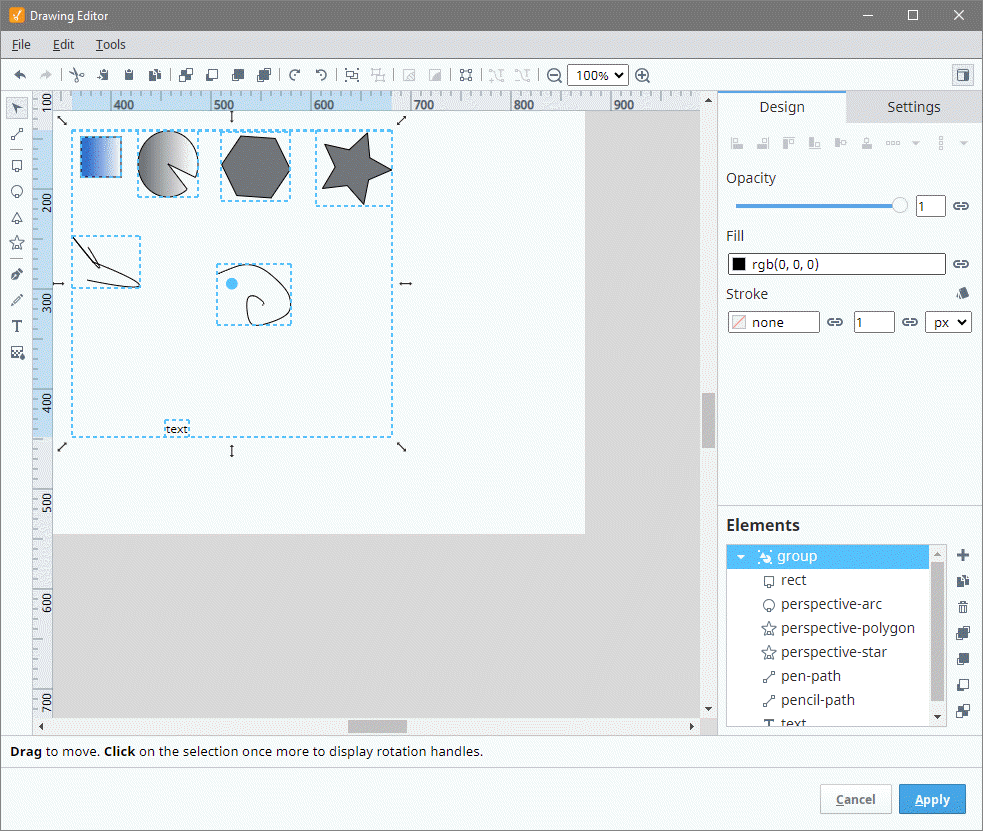

Drawing Editor​
The Drawing Editor can be opened in the Designer by right-clicking on the Drawing component within a Perspective view or from the Project Browser, and selecting Edit Drawing. You can open only one drawing at a time in the editor. While a drawing is being edited, the right-click context menu option on drawing instances in the Designer will be disabled.
The Drawing Editor supports importing vector graphics (SVGs) using drag and drop functionality.
The Drawing Editor interface consists of several sections to facilitate creating and editing drawings:
- Command Bar: Provides quick access to core actions like applying changes, undo/redo, and managing objects.
- Toolbox: Contains all the drawing tools used to create and modify shapes, lines, and text.

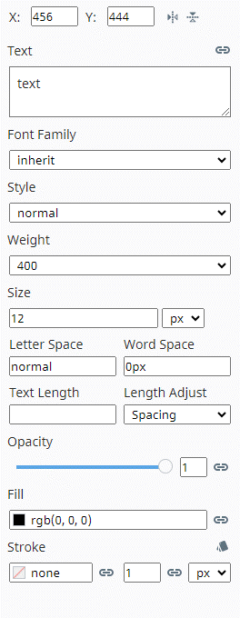

- Design Panel: Provides alignment, properties for selected elements, and group management options.

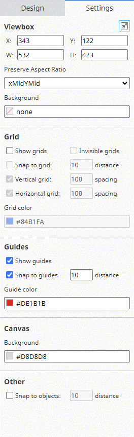

- Settings Panel: Allows you to configure the Canvas, grids, guides, and other workspace properties.

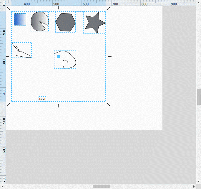

- Viewbox: Displays the current viewable area of the Canvas, defining the visible portion of the drawing.

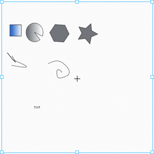

- Canvas: The central drawing area where you create and edit vector graphics.
- Status Bar: Shows useful information like cursor position, zoom level, and editing tips based on the current tool or action.
- Apply / Cancel Buttons: Located at the bottom of the editor, these buttons allow you to either save your changes or discard them.

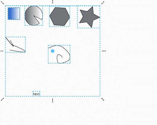

| Selection | Selects objects on the Canvas for moving, resizing, or transforming. | |

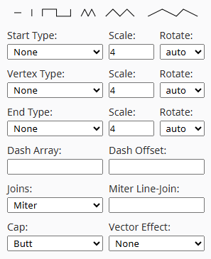

Stroke Configuration Menu​
| Property | Description |
| Start Type | Defines the style of the stroke's starting point.
| Vertex Type | Determines how stroke joins are rendered at vertices.
| End Type | Defines the style of the stroke’s ending point.
| Dash Array | Defines a pattern of dashes and gaps for the stroke, where entered values are read in an alternating pattern of dash and gap lengths. Accepts a comma or spaces to separate values. For example, 6,8 would display a dash of 6 units followed by a gap of 8 units, and so on. If only a single value is provided, it is applied to both the dash and gap length. |
| Dash Offset | Specifies where to start the dash array pattern along the stroke. Accepts positive and negative values. |
| Joins | Controls how two segments of a stroke join at a vertex. |
| Miter Line-Join | Sets the maximum miter length when using miter joins. |
| Cap | Defines the shape of the stroke's end caps (e.g., butt, round, square). |
| Vector Effect | Specifies how the stroke is affected by transformations. |
