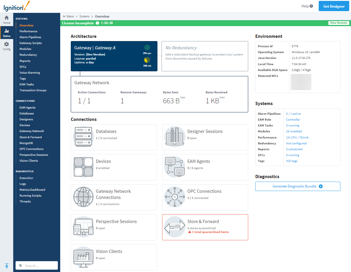

The Status tab provides both an 'at a glance' overview of all of the systems in your Gateway, while also giving you the ability to drill down into specific systems and get a more in depth view of what is currently happening in your system. The Systems and Connections sections that are displayed on the left side of the Status page are based on what modules are currently installed. Some 3rd party modules could potentially add sections that are not discussed in this manual.
When first opening the Status tab, you will be taken to the Overview page. This page provides an overview of all Ignition systems, while also acting as a launchpad to all other sections in the Status tab. The pages in the Status tab are built around the idea of quickly drawing attention to problem areas by highlighting them. As you can see, this Gateway has a faulted database. The pages in the Status tab also allow you to 'drill down' into sections to see more information. Most objects can be clicked on, like the faulted database. Clicking either of these will take you to the appropriate section, allowing you to quickly find out what is wrong with a particular system.
The Status section of the Gateway Webpage provides detailed information relating to the following parts:
