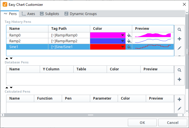

  7. Now that we have subplots, we'll put each of the different pens into a different subplot. Click on the Pens tab, select the row for the Ramp0 Pen, and click the Edit icon. For this example, we chose the following settings:
    1. Set the Subplot to 1.
    2. Set the Color to pink.
    3. Set the Style to Area.
    4. Click OK.
  8. For the Ramp2 pen, we selected the following:
    • Subplot: 2
    • Color: Blue
    • Style: Line w/Gaps
  9. For the Sine1 pen, we selected the following:
    • Subplot: 3
    • Color: Red
    • Style: Digital
