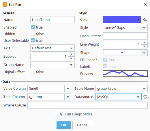

  4. The Edit Pen window will open. Here is where you enter your database pen data. In the very least, we'll need values for the following properties:
    We entered the following settings:
    1. Name - The name of the pen on the chart. Works the same as the name on any other pen.
    2. Datasource - The name of the database connection (as configured on the gateway) that contains the table we want to extract values from.
    3. Table Name - The name of the database table that contains the values that we want to represent on the chart.This dropdown will automatically populate with available table names once the Datasource property has a valid database selected.
    4. Value Column - The name of the column in the database table that contains the values we want to show, representing the value of the datapoint at a particular time. This column is ultimately responsible for the determining where each point lies on the chart's Y-axis. This dropdown will automatically populate with column names once a value for the Table Name property has been set.
    5. Time Column - The name of the column in the database table that contains a timestamp, representing the time of the datapoint. This column is ultimately responsible for determining where each point lies on the chart's X-axis. This dropdown will automatically populate with column names once a value for the Table Name property has been set.
    6. Axis - All pens require an axis. We can use the default here.
    Click OK to save your database pen settings.
