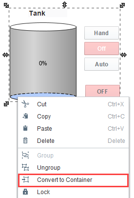

Font Scaling on Containers​
You can convert a group to a container to change the way scaling works. Ignition remembers the last layout Settings you made to each individual component in that group prior to the conversion to a container (i.e., if any of the components had font scaling disabled, once the group is converted to a container, those same components will still have font scaling disabled).
