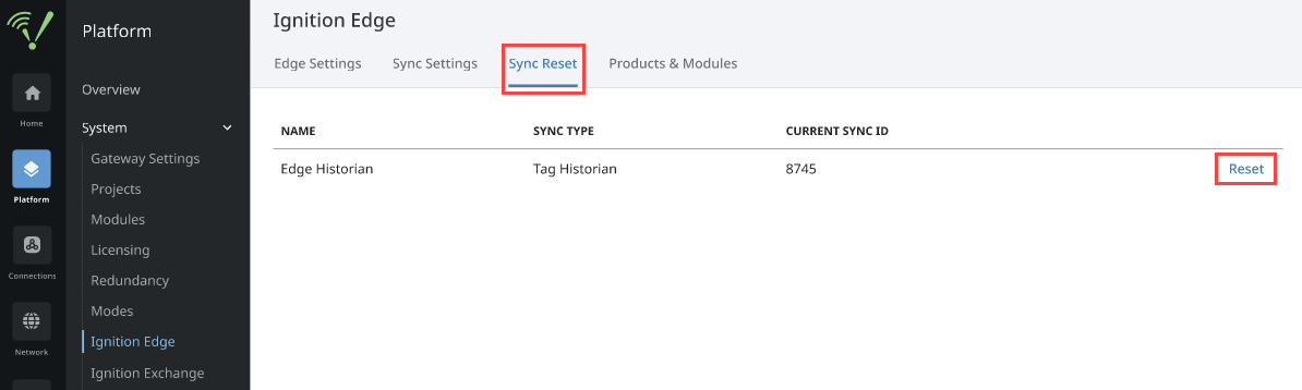

Data Synchronizationβ
Edge Gateways can synchronize operational data to a central Ignition Gateway. This allows data collected at the edge to be stored, analyzed, or visualized centrally.
The following data types can be synchronized:
- Tag History
- Alarm Journal events
- Audit Log records
This capability allows organizations to deploy distributed Edge systems while maintaining centralized visibility of operations.
