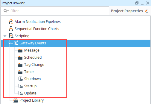

Gateway Event Scripts Overview​
Gateway Event Scripts are scripts that run directly on the Gateway. They are useful because they always run, regardless if any Sessions or Clients are open. They also provide a guaranteed way to make sure only a single execution of a particular script occurs at a time, as opposed to placing a script in a window where there could be multiple instances of the window open at any given point.
Note that even though Gateway Event Scripts run on the Gateway, they're still considered a project resource and are stored as readable PY files. Project backups will include any Gateway Event Scripts.
The Gateway Event Script workspace is located in the Scripting menu of the Designer or in the Project Browser under Scripting > Gateway Events.

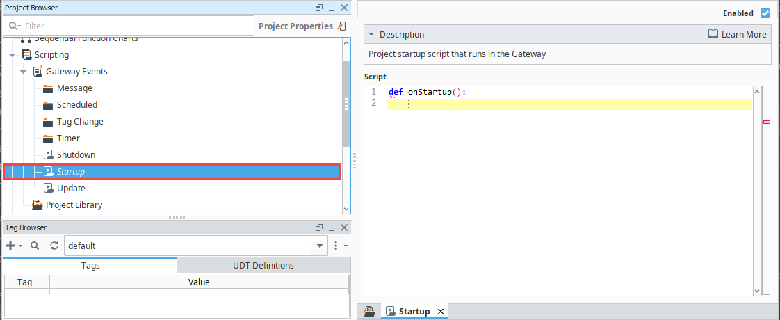

The Startup Script event runs at the startup of the Gateway. Additionally, if the project is restarted in some way, such as by making a change to a Gateway Event Script and saving, then the Startup Script will be called. This means that while editing scripts frequently in the Designer, the startup and shutdown events may happen frequently.
Gateway Startup Behavior​
There is a specific order to when the various Startup Scripts are run. When troubleshooting your Gateway startup times, consider the following:
  1. Gateway starts: The Gateway will start as an OS service, and start the context. No startup scripts can run before this is complete.
  2. Projects are started: This includes all of the Gateway-scoped items in the projects such as Transaction Groups, SFCs, etc. This does not refer to launching clients, and no clients can be automatically launched at this time. All Gateway Startup Scripts are run at this time for each project. Note that if you copied a project, always check for Gateway-scoped events such as these. You generally don't want a Gateway Startup Script to run twice because it is in two projects.

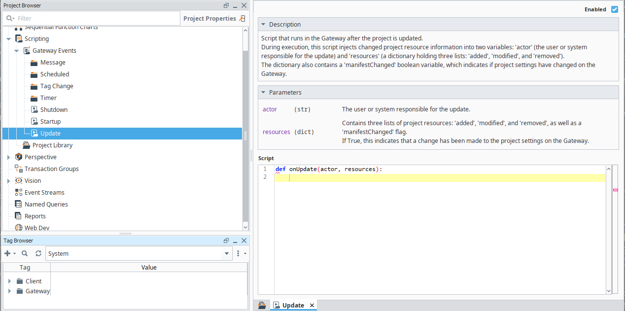

Update Script​
The Update Script event runs after a project is saved or updated on the Gateway. This enables you to insert a script that will run every time a project is saved.
This script reports which resources were modified during a project save and includes the following parameters.
ParameterDescriptionType
actorThe user or system responsible for the project update.String
resourcesA dictionary that holds the following keys:
  • added: List of dictionaries containing information about resources that were added to the project.
  • removed: List of dictionaries containing information about resources that were removed from the project.
  • modified: List of dictionaries containing information about resources that were modified.
  • manifestChanged: A boolean variable indicating whether or not a change has been made to the project settings on the Gateway.
Dictionary

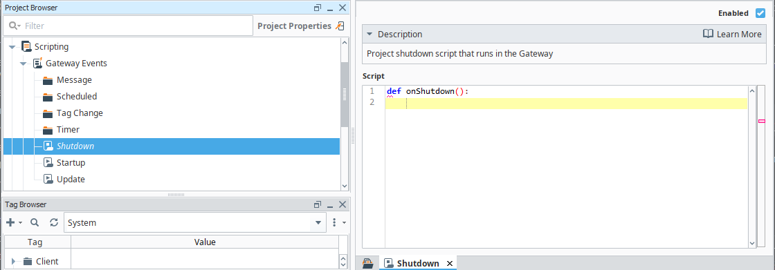

The Shutdown Script event runs at the shutdown of the project, which means it can be used as a way to trigger a script when the Gateway has to be restarted. It allows you to run a piece of code as the shutdown is occurring. After the script completes, the shutdown will finish.
note
The Shutdown Script event only gets called if the Gateway is requested to shut down. If power is lost abruptly (power outage, hard restart, etc.) this shutdown script will not run.
Gateway Shutdown Behavior​
Similar to how a Startup Script behaves, "Shutdown" in the context of this event means "project shutdown", so shutting down the Gateway would trigger this event, as well as disabling the project containing a script on this event. Additionally, making a change to a Gateway Event Script in the Designer, and then saving the project will cause the project to restart, which means this event can get called by simply making changes in the Designer and saving.

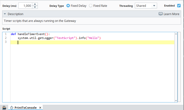

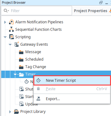

The Timer Scripts execute periodically on a timer at a fixed delay or rate. This allows you to set up a sort of heartbeat that can run on the Gateway. This is the ideal event to use if you need the Gateway to periodically perform some scripting task.
Since multiple Timer Scripts can be added, the Timer folder has a right-click menu to add new scripts. Once created, use each timer's right-click menu to copy, rename, or delete the script. Selecting a script will open it so that it can be viewed and modified.
Timer Script Settings​
Timer Script names are entered when creating the script. All other properties can be found on the top bar of the Script Editor. Below is an overview of the settings for a Timer Script:
  • Name: The name of the Timer Script. Names must be unique per project, so two Timer Scripts in the same project cannot have the same name.
  • Delay: The delay period in milliseconds. The meaning of this setting is dependent on the Delay Type setting.
  • Delay Type: Determines how the Delay setting is utilized.
    • A Fixed Delay Timer Script waits for the given Delay between each script invocation. This means that the script's rate will actually be the delay plus the amount of time it takes to execute the script. This is the default and safest option, since it prevents a script from mistakenly running continuously because it takes longer to execute the script than the delay.
    • Fixed Rate scripts attempt to run the script at a fixed rate relative to the first execution. If the script takes too long, or there is too much background process, this may not be possible. See the documentation for java.util.Timer.scheduleAtFixedRate() for more details.
  • Threading: Determines which thread this script should run in. In other words, this setting allows you to specify if you want this Timer Script to share execution resources or not. The rule of thumb here is that quick-running tasks should run in the shared thread, and long-running tasks should get their own dedicated thread.
    • The Shared setting means that all Timer Scripts will share a thread. This is usually desirable, as it prevents creating lots of unnecessary threads: threads have some overhead, so a small amount of resources are used per thread. However, if your script takes a long time to run, it will block other timer tasks on the shared thread.
    • The Dedicated setting will create a separate thread specifically for the Timer Script to use. This setting is desirable when your scripts executions must be as consistent as possible, as other Timer Scripts can't slowdown or otherwise impact the execution of a script in a separate thread.
  • Enabled: Allows you disable the Timer Script when set to false.

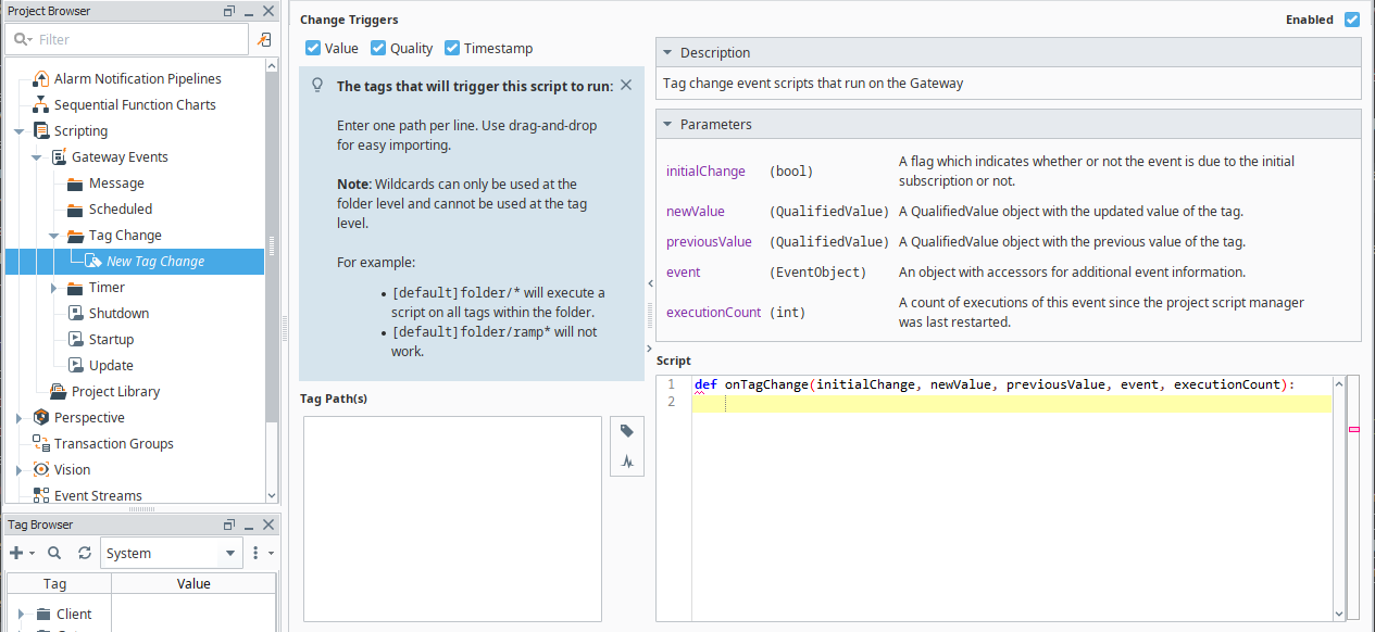

The Tag Change Script event allows you to specify any number of tags, and trigger a script when one of them change. Since these execute based on a tag changing value, Tag Change Scripts are ideal when you need a script to run based on some signal from a PLC.
Having the Tag Change Scripts run in the Gateway scope means that the scripts are active as long as the Gateway is running. Thus, you do not need a Client or Session to be open for a Gateway Tag Change Script to execute. When executing, each Tag Change Script runs in a separate thread. This prevents long running scripts from blocking the execution of other Tag Change Scripts.
note
Due to their nature, Client Tags will not trigger Gateway Tag Change Scripts. However, Client Event Scripts enable you to trigger a script based on a Client Tag changing value.
Tag Change Script Interface​
Select New Tag Change Script from the Tag Change folder right-click menu to name and add a script. Once created, use each Tag Change Script right-click menu to copy, rename, or delete the script. Selecting a script will open it so that it can be viewed and modified.
The following settings can be configured with a Tag Change Script:
  • Change Triggers: When the tag changes, the script can trigger based on the Value, Quality, and/or Timestamp. Note that regardless of how many triggers changed, the script only executes once per tag, so leaving all triggers enabled will not trigger three executions each time the tag changes.
  • Enabled: Determines if the script is active or not. Set to false to disable the script.
  • Tag Paths: A list of tag paths to monitor. When any of the tags listed in this area change, the script will trigger. Note that the list is not comma separated. New paths are specified on each line. The following items are included and accepted to assist with creating a tag path list:
    • The Tag Browser icon opens a Tag Browser window, allowing you to quickly lookup and add tag paths to the Tag Change Script.
    • The Path Diagnostic icon verifies the paths specified under the tag paths list. This is useful for checking for typos in the list.
    • Wildcards can be used at the end of configured tag paths. Using a wildcard will execute the script for all tags within the same folder. In the below example, the script "New Script" will run when the value of any tag in the "folder" folder changes.
      Using Wildcards in Versions 8.3.4 and Later
      Changed in 8.3.4
      You can now use wildcards at both the folder level to help specify a folder path, and at the tag level to help specify a tag path. Prior to 8.3.4, wildcards could only be used at the folder level. See the Wildcards in Tag Paths page for more example usage.
  • Script: Where the Python script associated with this event will be placed. The Tag Change Objects section describes the parameters included in this script.

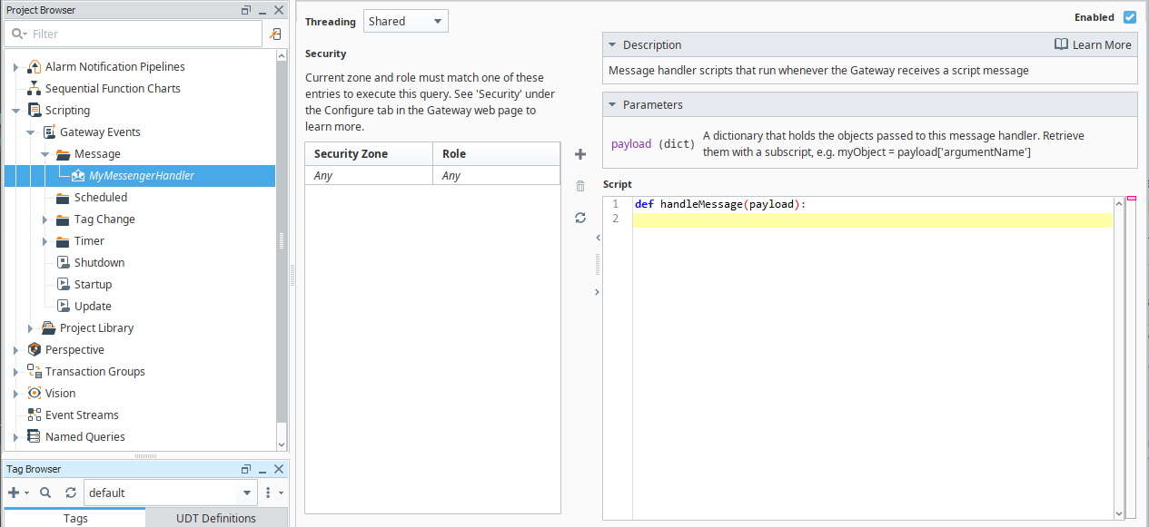

Message Handlers allow you to write a script that will run in the scope they are located in, but they can be invoked by making a call from other projects or even other Gateways. They can be called using three different scripting functions:
Select New Message Script from the Message folder right-click menu to name and add a script. Keep in mind that each message handler must have a unique name per project. Once created, use the right-click menu for each script to copy, rename, or delete the script. Selecting a script will open it so that it can be viewed and modified.
Gateway Message Handler Settings​
When adding or modifying a message handler, the following settings are available:
  • Threading: Determines the threading for the message handler. Contains the following options:
    • Shared: The default way of running a message handler. Will execute the handler on a shared pool of threads in the order that they are invoked. If too many message handlers are called all at once and they take long periods of time to execute, there may be delays before each message handler gets to execute.
    • Dedicated: The message handler will run on its own dedicated thread. This is useful when a message handler will take a long time to execute, so that it does not hinder the execution of other message handlers. Threads have a bit of overhead, so this option uses more of the Gateway's resources, but is desirable if you want the message handler to not be impeded by the execution of other message handlers.
  • Security: Allows you to specify security zone and role combinations that are allow to request this message handler.
The Payload​
Inside the message handler is your script. The script will have a single object available to it, the payload. The payload is a dictionary containing the objects that were passed into it. In essence, the payload is the mechanism that allows you to pass the message handler values.
The payload is simply a python dictionary, so extracting values involves specifying the key:
Pseudocode - Payload Values
value1 = payload["MyFirstValue"] # "MyFirstValue" is the key that is associated with a value. We are taking the value associated with MyFirstValue, and assigning it to value1.
value2 = payload["MySecondValue"] # Similarly, we are taking the value associated with MySecondValue and assigning it to value2.

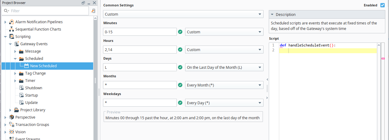

Gateway Scheduled Scripts​
Scheduled scripts are events that execute at fixed times of the day, based off of the Gateway's system time. Configuration for the event is split between two sections: Settings and Script.
Settings​
The Settings selections allow you to give the event a unique name and determine how often it executes. Schedules are driven by cron job scheduling.
The Common Settings dropdown contains several common selections, which can be further modified with the fields and dropdowns under each unit of time.
Each unit of time consists of a field, and corresponding dropdown. The dropdown is filled with suggestions and simple options, but more complex values can be provided in the field on the left. See Crontab Formatting Reference.
Script​
The Script field houses the Python script that will execute when the scheduled event executes.
