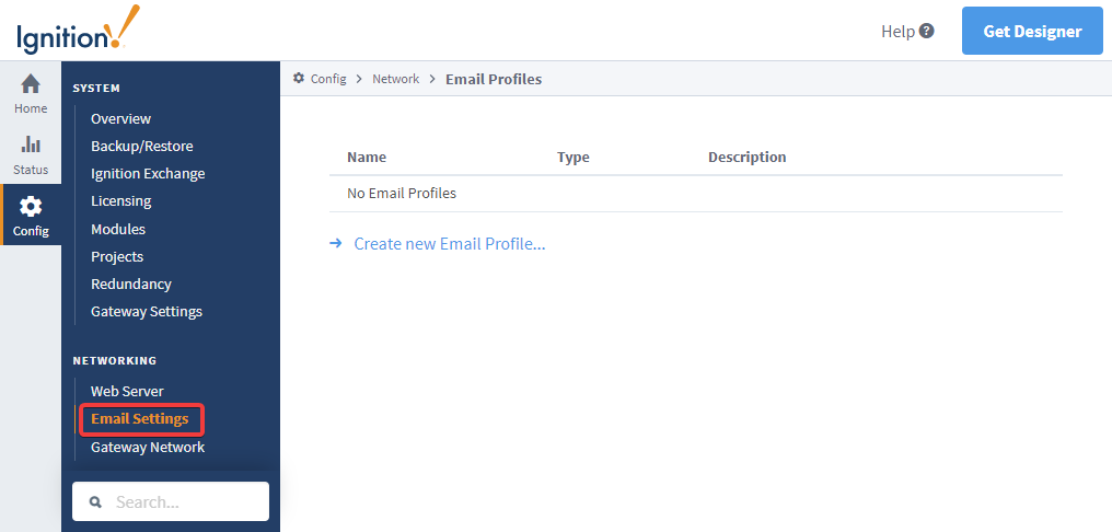

The Email Settings page allows you to select either basic authentication or OAuth 2.0 and configure an Email Profile from there. These Email Profiles can be used by several different resources in the Gateway. This means that instead of setting up an Email Profile within each resource (i.e., Alarm Notification Profile, Reports, etc.), you can configure them once here, and have those resources all use the same SMTP server. You can find the Email Settings in the Config section of the Gateway under the Networking heading. Here, you can create a new Email Profile, or manage your existing profiles.
Setting Up an Email Profile

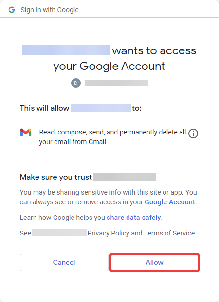

  4. Since we are using a Google Email Profile, we are redirected to a Google permission prompt. Click Allow to continue.
    Manage Token Example Step 4
  5. After the authorization server grants the initial access token, you will be redirected back to the Gateway, After a few seconds, the Gateway will refresh, showing a valid access token.

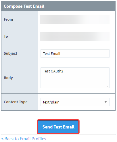

  2. This will bring you to a page where you can compose your test email.
    Test OAuth2 Email Profile Example Step 2
  3. Fill out the form. The From field should be populated with the email address that will be sending the email, and the To field should be the test email's recipient. Click on Send Test Email when you are done.
    Test OAuth2 Email Profile Example Step 3
  4. If the email sent successfully, you should receive a notification below the Send Test Email button.
