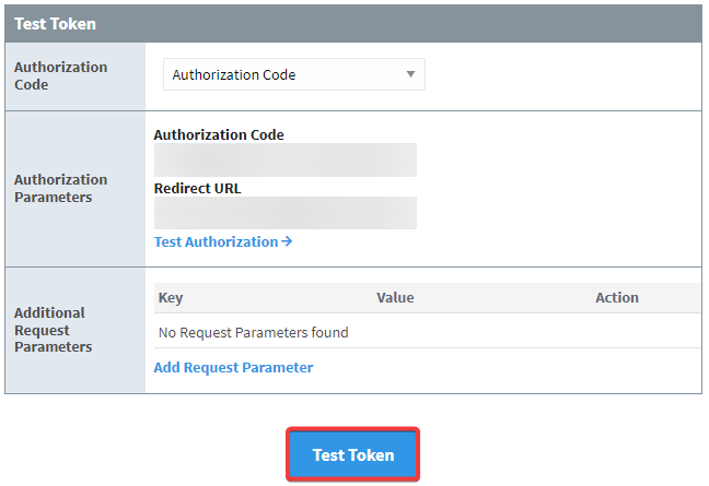

Test Tokenβ
The test token option is useful in cases where you want to test the authorization code to make sure it successfully gives the Client an access token. It is also useful if you want to test an access token request using a client credentials grant, or refreshing an access token using a refresh token. During this process, the Gateway will make an access token request against the authorization server using one of three methods and get a response back. To see an example of this process work alongside testing authorization, see the Test Authorization and Token Example.
You can find the test token option on the OAuth2 Clients page.
The section below details the Authorization Code, Client Credentials, or a Refresh Token grant types, with the main difference between the three being the type of information you will need to enter.
- If you use an Authorization Code, you will need to enter an Authorization Code, Redirect URL, and any additional Request Parameters. Once you input that information, click on "Test Token".
- If you use Client Credentials, you will need to enter a scope and any additional Request Parameters. Once you input that information, click on "Test Token".
- If you use a Refresh Token, you will need to enter the Refresh Token, scope, and any additional Request Parameters. Once you input that information, click on "Test Token".

noteBesides the main OAuth2 Client page, you can use the Test Token button on the authentication results page to test access tokens. The benefit of testing your token from the authentication results page however, is that some information, such as the Authentication Code and Redirect URL will already be filled out based off the information from the authorization test.
Click on the "Test Token" button on the authentication results page. This will bring you to the Test Token page, where some fields will already be filled in.
Click on "Test Token" to see what the token test results will be.
A "Token Response" dialog box will appear, showing the results of the token test, as well as timestamps, the response, and more. Click Done to close out the dialog box.
