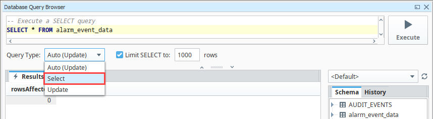

New in 8.1.32
The Query Type field displays the mode that is used when a query is executed. By default, this field will show Auto, which will change to reflect the query type mode as a query is entered to show either Auto (Select) or Auto (Update). This allows confirmation that the correct mode is used when executing the query. If the auto-detected mode is incorrect, the drop down includes Select and Update to set the mode type.
For example, since the check for the query string will assume an update is being run if it doesn’t detect SELECT text at the beginning of a query, you may want to use the Query Type dropdown to choose Select as the mode option to confirm the query will execute correctly.
