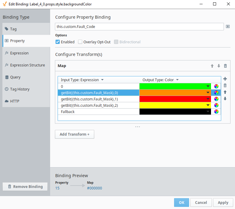

Expression to Color​
This is linked to the background color property of a text field.
  • Input Type: Expression
  • Output Type: Color
This input is passed through several expressions before selecting the Fallback value of black (#000000). You can see in the Binding Preview at the bottom that the original value of the property binding is 15. For each expression past the first, a single bit of that integer is being tested. Since none of bits 0, 1, or 2 are true, we get the fallback. For more information on the getBit() function, see the appendix.

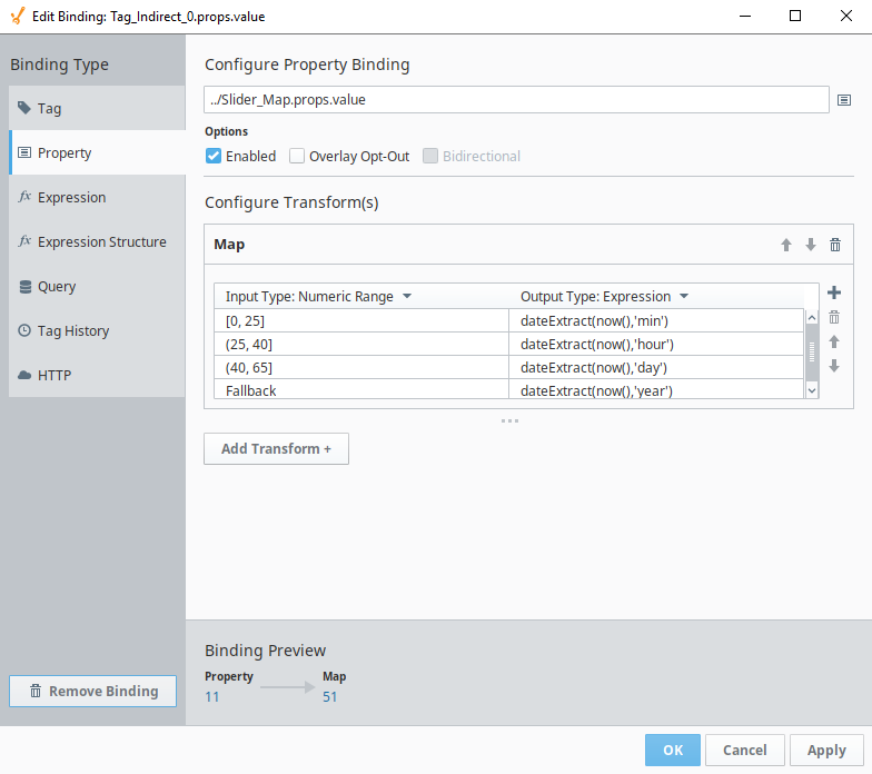

Numeric Range to Expression​
  • Input Type: Range
  • Output Type: Expression
This mapping maps different ranges of values to different parts of the current time. You can see in the Binding Preview at the bottom that the original value of the property binding is 11 so we get an output value that pulls the minute out of the current time. That was 51 at the time this screenshot was taken.
