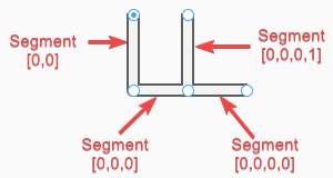

Pipe Segment​
The segment formed by a Pipe Connection, and one of its immediate child connections. A segment is a visual representation of relationship between other connections. Each connection has an array of connection indices (starting at 0), and segments can be represented as a series of indices. For example, [0,1,0] would represent the first pipe, second connection, then first sub connection.
Consider the simple pipe below of three connections and two pipe segments. The top of Segment [0,0] is the origin and the bottom of Segment [0,0] is the pipe connection where Segment [0,0,0] begins, turning the pipe flow from a vertical to horizontal direction. The end of Segment [0,0,0] is the final connection.
We can add two new connections, which could look like the following diagram. Because of the connection locations, Segment [0,0,0,0] follows the existing naming structure, but Segment [0,0,0,1] is given the number 1 since it was added later and is the second child.
Note that segment indices are represented in the Project Browser.
