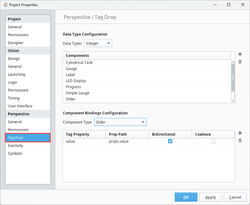

Perspective Tag Drop Properties​
Tag Drop properties provide a way to link certain data types of Tags to commonly used components when dragging-and-dropping a Tag onto a view. This is done in Project Properties under Tag Drop in three steps: select the data type, select the component to create, and select the bindings that are created on that component.
  • Data Type Configuration: This setting determines which components show up in the popup list when dragging a Tag into a view. You can switch between the different tag data types to see what sorts of components are allowed to be dropped for each of those types. Add or remove new entries in the list using the Add icon and Delete icon. You can then double-click on the new blank cell and select a component from a dropdown.
  • Component Bindings Configuration: This setting determines which bindings are created when a component is dropped into a view. Select a component, then set up or modify the bindings for the selected component (which is typically just the Tag value bound to the value/text prop on a component). Add or remove new binding entries using the Add Alt text icon and Delete icon. Double-click the Tag Property and Prop Path cells to fill in properties.
    • The Tag Drop interface includes Bidirectional and Coalesce settings when adding components where these settings can be applied.
note
The Component Binding Configuration table values are tied to the component currently selected in the Component Type dropdown, they are not related to what is selected in the Data Type Configuration table above.
Dropping tags onto existing components can now create bindings on those components if the data type of the tag matches a Tag Drop configuration in the project. Tag Drop configuration is what determines if a binding is configured or not.
Tag Drop​
PropertyDescription
DataType ConfigurationThis section is to set up a list of components to show for each data type that can be dragged onto the view.
Data TypesA dropdown list of the available data types in Ignition. Choose a datatype to see a list of components associated with it.
ComponentsA list of components associated with selected data type.
Component Bindings ConfigurationThis section is to set up bindings when a tag is dropped.
Component TypeA dropdown list of the available components in Perspective.
Tag PropertyThe name of a tag's property to be used in a binding. value is most commonly used.
Prop PathThe property path on the component where the binding will be created. props.value or props.text are most commonly used.
BidirectionalA check box to indicate if the binding should be bidirectional. The Bidirectional property is set by default when adding Input Components.
CoalesceA check box that when checked ensures target property changes of child properties are combined into a single write back to the source. This setting applies to Bidirectional bindings only.
