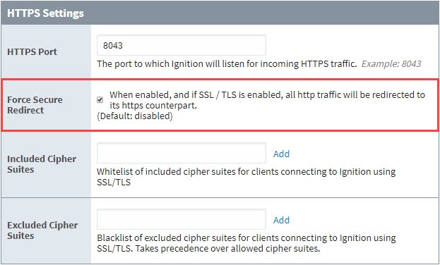

Enabling Force Secure Redirect​
Normally, Clients, Sessions, Designers, and Web browsers that communicate with the Gateway will do so over an HTTP. However, you can force these communications to be redirected to the more secure HTTPS.
  1. Go to the Config section of the Gateway Webpage.
  2. Choose Networking > Web Server from the menu on the left.
  3. Select the checkbox for Force Secure Redirect, and click the Save button at the bottom of the page.
    Enabling Force Secure Redirect Step 3
When enabled, all requests between the host Gateway and any Clients, Sessions, Designers, or web browsers will be redirected to the HTTPS port (by default, port 8043), and thus encrypted. However, you will likely want to install a security certificate signed by a certificate authority.
Note that although the Gateway Network may share the same port as HTTP traffic, Force Secure Redirect settings will not apply.
