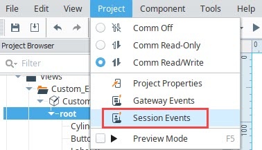

Configuring Session Events​
To start working on a Session event script:
  1. In the Project Browser, double-click on the Session Events section:
  2. The Session Events dialog will appear:
  3. Configure a script by selecting one of the events on the left-hand side.

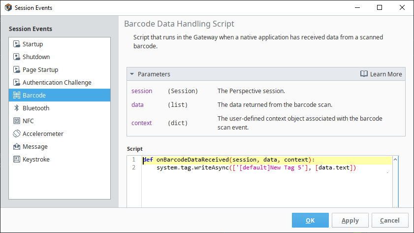

Startup and Shutdown Event Scripts​
Startup and Shutdown events run, naturally, whenever a Session starts or ends. In each case, the Gateway will have access to the session object associated with the section, complete with all Session properties.

Barcode Example​
This example will scan a barcode, and write its value to a tag.
  1. For this example, drag a Button component and a Label component onto a view.
  2. Create a new Memory tag with a data type of String. Set the value to Please scan a barcode.
  3. Bind the text of the Label to the new tag.
  4. Right-click on the Button component and choose Configure Events.
  5. On the Event Configuration screen, select Mouse Events > onClick.
  6. Click the Add icon and select Scan Barcode action.
  7. Click OK. Next we need to set up a session event so that Perspective knows how to interpret the scanned barcode data.
  8. Under the Project tab, select Session Events.
  9. On the Session Events screen, select the Barcode icon.
  10. Add the following script to the page:
    system.tag.writeAsync(['[default]New Tag 5'], [data.text])
    note
    We used the tag created for this example, New Tag 5. You can enter your own tag name if different.
  11. Click OK and save your project.
