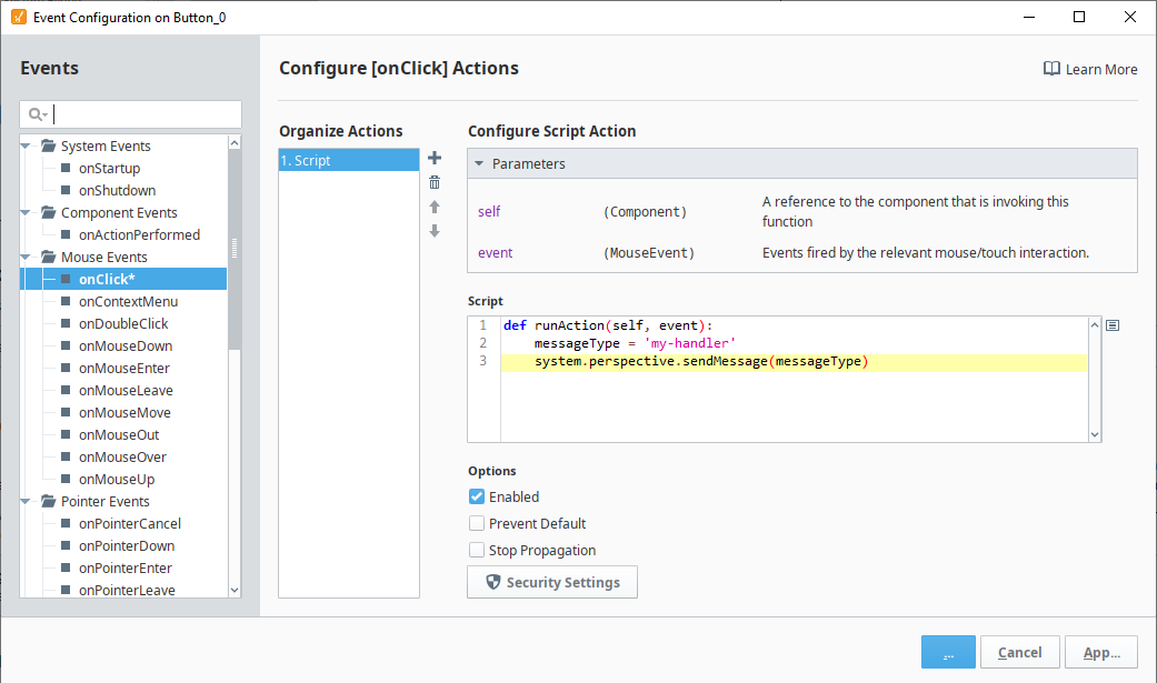

In this step, we place a script on the Button that will call our Message Handler.
  1. Right-click on the Button, and select Configure Events.... The Event Configuration window appears.
  2. We want our script to trigger when the button is pressed. On the left side of the window, in the Mouse Events folder, select onClick.
  3. The Organize Actions list will appear. Press the Add icon. A popup list will appear.
  4. Select the Script action.
  5. Add the following code:
    Python - Sending a Message
    messageType = 'my-handler'
    system.perspective.sendMessage(messageType)
    Make sure the script lines are indented one time.
  6. Click OK to apply the script.
The example is now running. From the Designer, enable Preview mode, and then click on the Button component. The text on the label should update.
