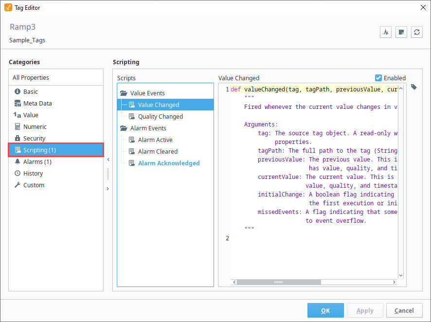

Scripts can be attached to tags. When you edit a tag, you can navigate to the Tag Events section and click on the Edit icon to see a list of all of the available events. Those events are
  • Value Changed
  • Quality Changed
  • Alarm Active
  • Alarm Cleared
  • Alarm Acknowledged

Event Options​
Once an event has been selected, note that the top of the text area is defining a function. As a result, all code that should execute when this event occurs should be indented at least once to be included in the definition.
Value Changed​
The Value Changed event is fired whenever the value of this particular tag changes. Prior to 8.1.32, this script will also fire whenever the quality or timestamp changes since tags use a QualifiedValue, which includes a value, quality, and timestamp. As of 8.1.32, this event will only trigger on the value of the tag changing, and the quality and timestamp changes are ignored. Refer to Scripting Object Reference for more information.
