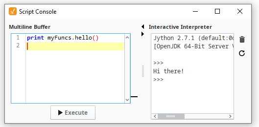

For example, we could open the Script Console (Tools menu > Script Console), write the following, and execute the script.
Each script resource can contain multiple functions and objects. As you add new function definitions, the list on the right will populate giving you a quick way to navigate through long scripts.
