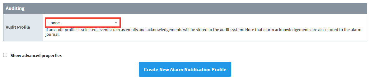

Alarm Notificationβ
Alarm notifications do not use the Gateway or project Audit Profiles. To audit alarm notification actions, you must create an individual Audit Profile, and then select the desired Audit Profile within the Alarm Notification Profile's configuration form.
Alarm Notification Attemptsβ
Attempts to send out alarm notifications are recorded in the auditing system. Specifically, the Gateway will record when it attempted to send out a notification, as well as if the attempt failed (such as the SMTP server refusing the request). It is important to note that the auditing system can not report failures that occur outside of the Gateway. Thus, if a voice notification fails to send due to some error in the VOIP system, it's possible that the Gateway won't report the VOIP error, but the audit log will have an entry stating that the Gateway attempted to send the notification.
