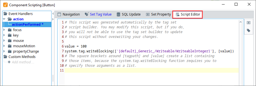

Set Tag Value Script Builderβ
The Set Tag Value Script Builder responds to an event by setting the value of a Tag. You can set the Tag to either a literal value directly typed in, but we recommend using the chain link Tag icon to have the event handler use the value of another property from the same window.
Use the steps below to create a Set Tag Value.
- Under the Set Tag Value tab, click the Set Tag Value radio button.
- Click the Tag
icon and choose a Tag from the Tag browser list to write to (i.e., WriteableInteger1).
- In the To this Value field, enter a number (i.e., 100) or click the Property
icon to to browse for a component property to use as the set-to value.
- Press OK to commit the change.
Set Tag Value Builder Scriptβ
The Set Tag Value script shown below was generated by the Script Editor. Compare the settings in the Set Tag Value tab with the documented code in the Script Editor and you'll see the Tag is set to "WriteableInteger1" and the Tag value is set to "100."
value = 100
system.tag.writeBlocking(['[default]_Generic_/Writeable/WriteableInteger1'], [value])
# The square brackets around [tagpath] and [value] create a list containing
# those items, because the system.tag.writeBlocking function requires you to
# specify those arguments as a list.
