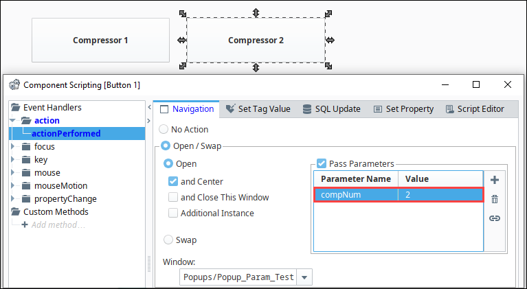

  3. Now, create a second compressor button. A quick way to do this is duplicate (Ctrl D) the Compressor 1 button so it inherits the script. Update the Text property to Compressor 2.
  4. Right-click on the new Button component and select Scripting. Update the parameter Value being passed in from a 1 to a 2.
  5. Click OK to save the script.

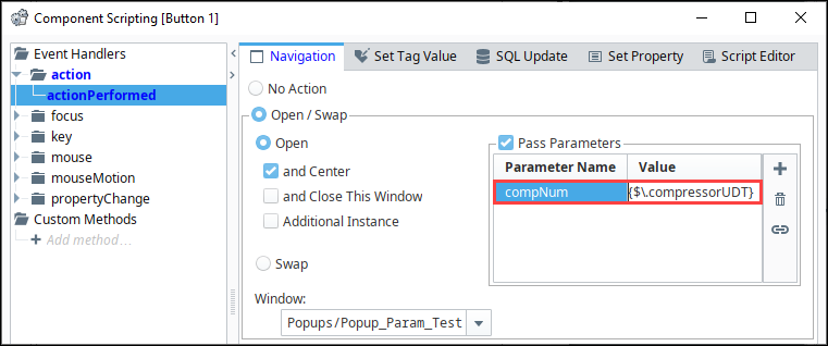

Passing a UDT to a Popup​
Inductive University
Parameterized Popup Window and UDTs
Watch the video
In addition to the basic types, parameters can be a complex UDT type. This works much the same as passing in basic values, where the popup window has a custom property on the root container, and a parameter is passed in when opening the window.
The difference is that the custom property on the popup window needs to be a UDT that has been previously defined, and the value being passed in when opening the window needs to be an entire UDT instance. This gives the popup access to every Tag within the UDT, which can be useful when making popups that show all the details of a certain area which has a UDT.
