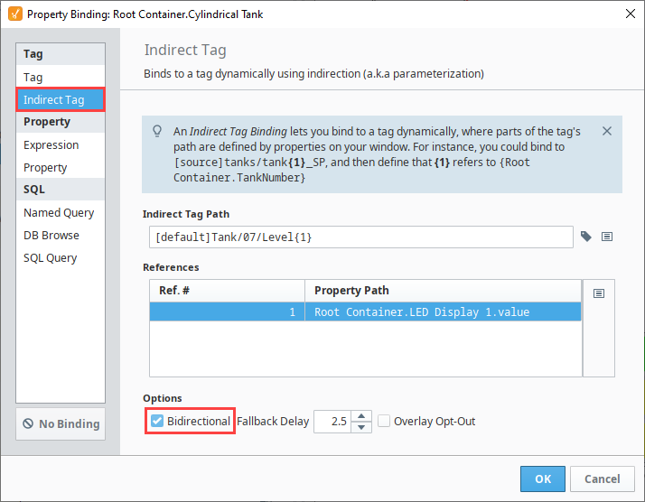

First there is the Indirect Tag Path. This field is where the Tag Path with parameters needs to be entered. Indirect Tag Bindings use numbered parameters at places in the Tag Path where indirection is going to occur. To the right of the Indirect Tag Path field are the Tag and Property reference helper buttons. The Tag button will enter the full Tag Path of the selected Tag into the Indirect Tag Path, while the Property button will add a new parameter reference to the Indirect Tag Path, and bind it to the selected property. The last area is the list of references, where each row in the list corresponds to a 1 parameter reference, and each row can be bound to property on the window. To bind a parameter reference to a property, simply select its corresponding row, and use the property selector to the right of the References list to select a property from the window.
tip
Putting some thought into your Tag structure will make using the Tags indirectly much easier!
Bidirectional Indirect Tag Binding​
Indirect Tag Bindings can also be made Bidirectional by clicking the Bidirectional checkbox at the bottom of the binding window. This will allow any input from a user on that property to be written back to the Tag. To work properly, the Tag needs to have the proper security to accept writes.

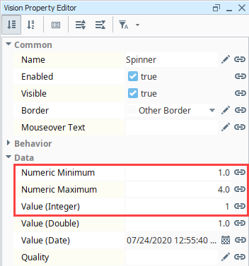

  2. Then drag a Spinner component onto the window. This we will use to enable the user to select which motor they are looking at.
  3. There are four motor Tags, so change the Numeric Maximum property of the Spinner to 4, and the Numeric Minimum property to 1. You may also need to change the Value (Integer) to 1.

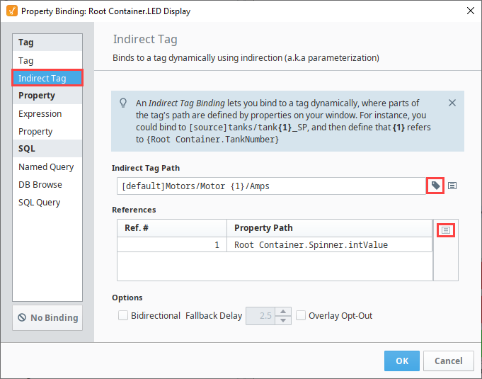

  4. Select the LED Display component. Click on the Binding icon next to the Value property of the LED Display.
  5. Select the Indirect Tag type.
    1. Click the Tag icon and select the Motor 1/Amps Tag.
    2. Delete the '1' in the Tag Path, and replace it with 1.
    3. In the References section, select the row, and click the Insert Property Value icon. Select the Value (Integer) property of the Spinner.
    4. Click OK to save the binding.

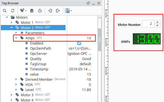

  6. To test it out, put the Designer into Preview mode . Notice how the value represented in the LED Display depends on what value is in the Spinner. Because the Spinner has the maximum value set to 4, users won't be able to set a motor number that does not exist. Additionally, adding new motors simply means adjusting the maximum value on the Spinner.
