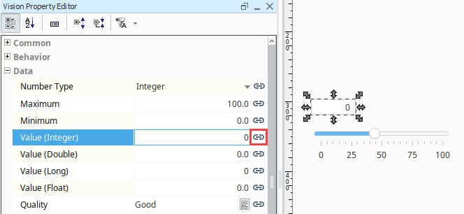

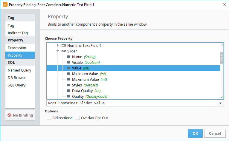

  1. Place a Numeric Text Field component and a Slider component on window.
  2. Select the Numeric Text Field.
  3. Click the Binding icon next to the Value (Integer) property.
  4. Select the Property Binding Type. Choose the Slider's Value property.
  5. Click OK. Put the Designer in Preview Mode .
  6. Move the slider. You'll see that the value from the Slider component appears in the Numeric Text field.

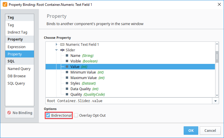

Property Bindings have the ability to become Bidirectional, meaning instead of having the binding go one way only, it will work both ways, even with just the one binding. Take the previous example with the Numeric Text Field and Slider again. When changing the value of the Slider, the Numeric Text Field would update, but updating the value of the Numeric Text Field would not update the Slider. If we reopen the binding on the Value (Integer) property of the Numeric Text Field, we can see in the bottom left corner a checkbox for Bidirectional.
Check the Bidirectional option and then save the binding. It will now be a bidirectional binding.
