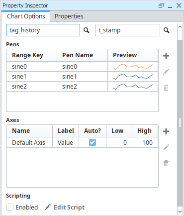

The Timeseries Chart is a type of XY chart whose domain or X-Axis represents time series data and range can be one or more pens. The Timeseries Chart is a great way to display data visually from Tag History, or similar time related data sources.
Usage​
To use the chart, drag the component from the Report Palette to your report. Type or drag a data key from the Key Browser into the Data Key field of the Chart Options tab in the Property Inspector. Select a time series domain (for example a t_stamp column of your query). The Y axis (value) can be modified in the Chart Options tab, but the X axis (time range) is based on the data in the Data Key that powers the chart dataset.

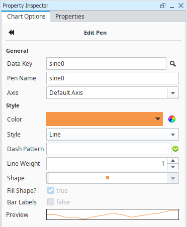

To add pens to your query, click the Add icon on the Chart Options tab next to the Pens table in the Property Inspector. You can select a pen row and click the Edit icon on the right side, or double-click the Range Key or Preview fields to navigate to the Edit Pen area. Double-clicking on the Pen Name field allows for renaming the pen only. Click the Back to chart options icon to return to the Chart Options tab.
Chart Options area
Pen Configuration area

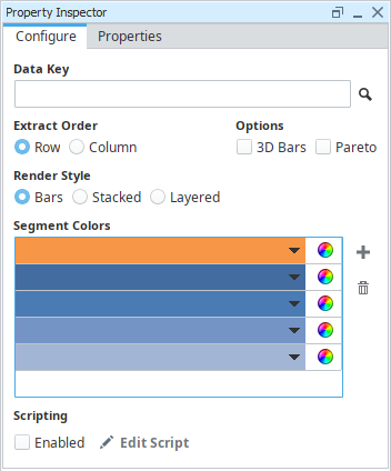

Bar Chart​
The Bar Chart component can be used to add bar charts to a report. It uses text categories on the X axis, and can also be configured as a Pareto chart.
Usage​
To create a Bar Chart, simply drag the component from the Report Palette and drop it onto your report. Bar Charts are have a number of customization options to adjust colors and rendering styles. When configuring a Bar Chart, take special consideration with the Extract Order property as it will impact how the data is grouped for the numerical bar values to be plotted. A Bar Chart example can be found in the Report Workflow Tutorial.

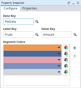

Pie Chart​
The Pie Chart adds a Pie Chart based on a simple two column data structure.
Usage​
To create a new Pie Chart, drag the pie chart palette item from the Report Design Palette onto your Report Page or Parent Shape. A pie chart has a simple configuration consisting of label values (generally Strings) and numeric quantity values. Color segments can be added or removed by clicking the Add or Remove icons on the Configure tab.
The Pie Chart in the images above was created using a simple data source which had just two columns, the first which represented our Label, and the second being a column of values.
Fruits, Amount
"Bananas", 52
"Grapes", 154
"Apples", 58
"Pineapples", 25
"Other", 265
