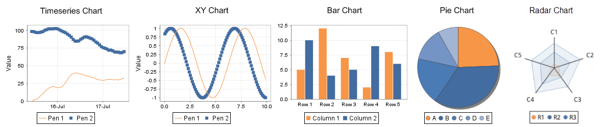

Report charts allow you to display your data in a graphical way, just like the charts in the rest of Ignition. Charts can be driven by any data source in a report, or even embedded into table rows using nested data sets. There are four types of charts to choose from when deciding how you want to show data:
  • Timeseries Chart: a simple chart that plots values against a timestamp X axis. Great for showing historical trending.
  • XY Chart: similar to the Timeseries chart, this chart plots lines on X-Y axes, but is configured to show numeric categories on the X axis.
  • Bar Chart: a bar chart that uses text categories on the X axis. Can be configured as a Pareto chart.
  • Pie Chart: a basic pie chart that uses text categories. Percentages are automatically calculated.
  • Radar Chart: a radar chart that compares values and can be configured to extract data by column or row.

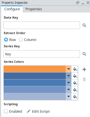

To create a Bar Chart, simply drag the component from the Report Palette and drop it onto your report. Bar Charts are have a number of customization options to adjust colors and rendering styles. When configuring a Bar Chart, take special consideration with the Extract Order property as it will impact how the data is grouped for the numerical bar values to be plotted. A Bar Chart example can be found in the Report Workflow Tutorial.

A common use of Radar Charts is to display realtime information in such a way that outliers can be quickly identified. This can be an efficient way to convey if a process is running on-spec or off-spec at a glance. To create a Radar Chart, drag the Radar Chart palette item from the Report Design Palette onto your Report page. Once data is added, the Extract Order property determines how the data will be displayed on the chart.
Color segments can be added or removed by clicking the Add or Remove icons on the Configure tab based on the number of elements the chart is showing.
