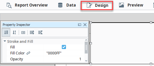

Colors in Hexadecimal​
First, hexadecimal case-insensitive color codes may be used. The code must be wrapped in quotation marks to be evaluated correctly. Note that the color change will only appear when the report is executed. The easiest way to test the expression is to switch to the Preview Panel.
Below we see a Blue hexadecimal code of "0000FF" is used on the Fill Color of a Rectangle. The Fill Color on the Rectangle was originally set to White. Because the expression will not evaluate in the Design Panel, the Rectangle will appear as a White color.
Colors in Expressions - Design
However, switching over to the Preview Panel will generate the report, and evaluate the expression. This in turn returns a Blue Fill Color.
Colors in Expressions - Preview
