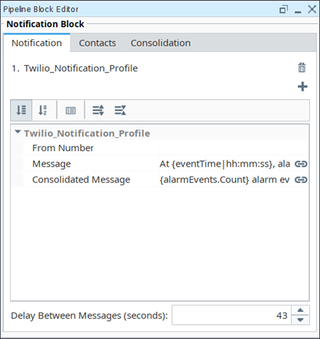

Twilio Settings​
SMS notifications can also be sent with the Twilio Alarm Notification module. To use Twilio, you must first set up Twilio SMS Notification. This does not require a cellular modem, but the Gateway must have Internet access, and a Twilio account with SMS capabilities must be created ( www.twilio.com ).
SettingDescription
From NumberNumber from which the alarm notification is sent.
MessageMessage to send. Default is At {eventTime|hh:mm:ss}, alarm {name} at {displayPath} transitioned to {eventState}. Click the binding  icon to access other alarm properties that can be used for the message.
Consolidated Message
New in 8.1.2
The message sent when consolidation is turned on, and more than one alarm is being sent. See the Notification Block section for more details. In release 8.1.2 this setting was renamed from "Throttled Message" to "Consolidated Message."

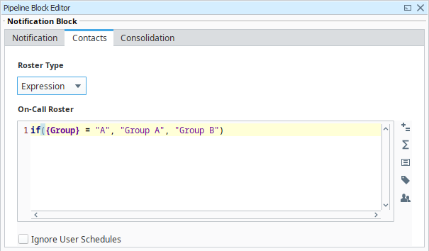

Expression​
The Expression roster type makes it possible to dynamically choose a single, predefined roster from within the pipeline. The expression can make use of Tag values, alarm properties and associated data. The alarm properties are accessible from the Alarm Properties icon located on the right side of the panel. Associated data can be manually entered using the { and } characters. A list of rosters is available from the On-Call Rosters icon.
The above expression checks for associated data named "Group" on the alarm. If the value is equal to "A", the Group A roster is used, otherwise the Group B roster will be notified.

if({Group}= "A","Group A","Group B")
Ignore User Schedules​
New in 8.1.13
This setting allows the notification block to ignore the schedules of any of the users in the roster, notifying users that would normally be "off shift". This setting is available on the Direct and Expression roster types.
caution
Changed in 8.1.25
Be mindful of your User Source settings when using this feature.
Users belonging to User Sources where the Schedule Restricted property is checked means that even though they will received alarm notifications when they are off shift, they will not be able to log in to address any alarms until their assigned schedule is active.
