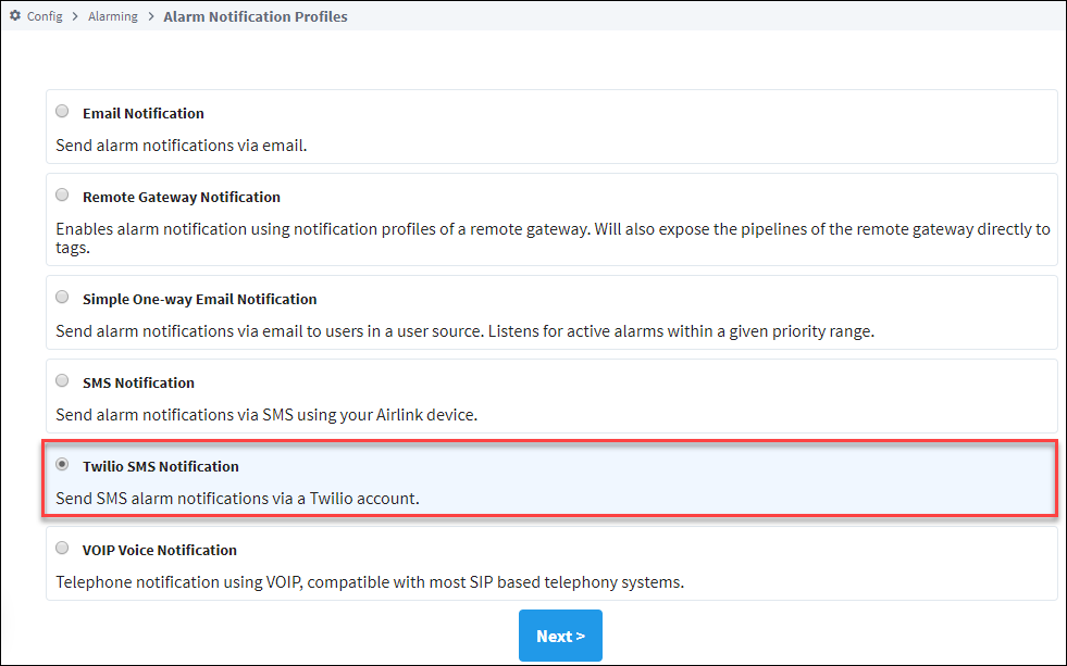

Create a Twilio SMS Notification Profile​
  1. Go to the Config section of the Gateway Webpage.
  2. Scrolll down and select Alarming > Notification from the menu on the left side.
  3. Click on the Create new Alarm Notification Profile link.
  4. Select the Twilio SMS Notification profile type, and click Next.
  5. Provide a name for the profile, and select a Twilio Account from the dropdown.
  6. Set the other profile settings as desired. (See table below for a description of all settings.)
  7. Click Create New Alarm Notification Profile.
