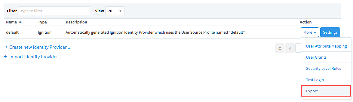

Import/Export an Identity Provider​
Another option for adding an Identity Provider to your Gateway is to import one. You must first have a file of an existing configuration, which can be taken from a Gateway by clicking More for the desired Identity Provider and selecting Export.

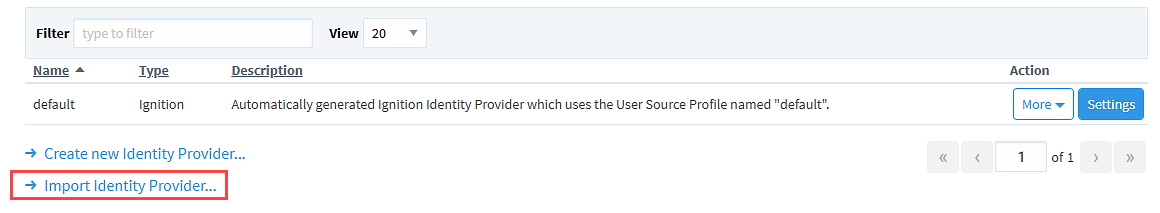

Now, from the Identity Providers page on the Gateway you want to import on, you can select the Import Identity Provider... link.

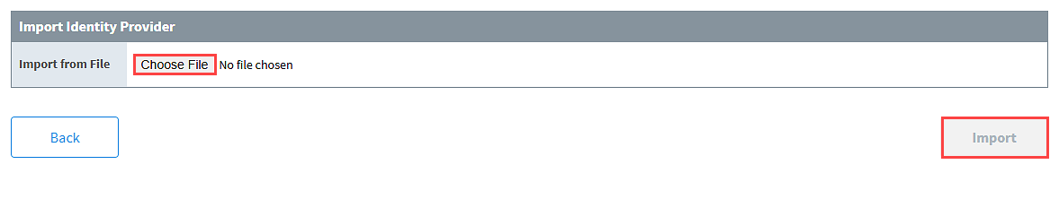

Click Choose File from the Import Identity Provider page. Once you have your file loaded, select Import.
A success message will appear at the top of the screen and the Identity Provider will now be listed on the page. Note that if your import file has any missing configuration values, they will be imported as the default values.
