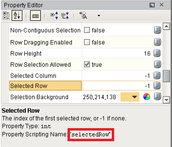

We see table.selectedrow as the first parameter being passed to the getValueAt() function. We checked into the table variable earlier, so this doesn't necessarily mean that the variable is the problem, although there is no harm in double checking, especially if you have not personally verified the variable. Assuming that the table variable is correct, let's check the attribute. We can check the Property Editor in the Designer to find a matching property, or head over to the Power Table page in the manual and check the property reference. We can see that there is a Selected Row property on the Power Table, but it should be spelled "selectedRow" with a capital "R".
We also know that the getValueAt() function takes a row index as the first parameter, so it would make sense that our code has a typo.
Solution​
We should fix the typo in the attribute name.
Python - Line 5 Updated
userSelectedValue = table.data.getValueAt(table.selectedRow, table.selectedColumn)
