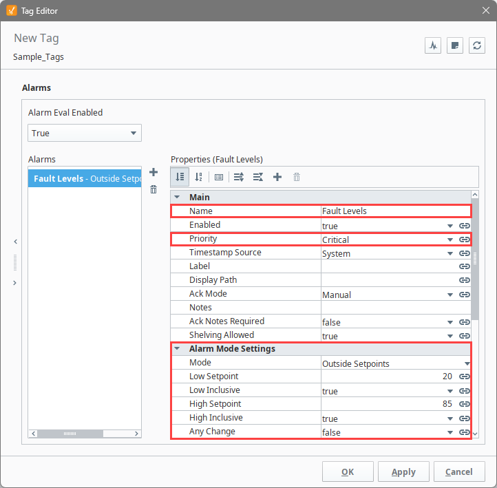

Configuring an Alarm on a Memory Tag​
This example uses a Memory tag with an Integer data type.
  1. In the Tag Browser, double-click a Memory tag to open the Tag Editor.
  2. In the Categories panel, select Alarms.
  3. Click the Add icon in the bottom-left corner of the window, or double-click the New Alarm item to add a new alarm.
  4. Configure the following alarm settings:
    • Name: Fault Levels
    • Priority: Critical
    • Mode: Outside Setpoints
    • Low Setpoint: 20 (alarm triggers when the value falls below 20)
    • Low Inclusive: true (alarm also triggers when the value equals 20)
    • High Setpoint: 85 (alarm triggers when the value rises above 85)
    • High Inclusive: true (alarm also triggers when the value equals 85)
    Tag Editor showing the Fault Levels alarm configured on a Memory tag
  5. Click Apply to save your alarm.
  6. Click OK to save your tag edits.

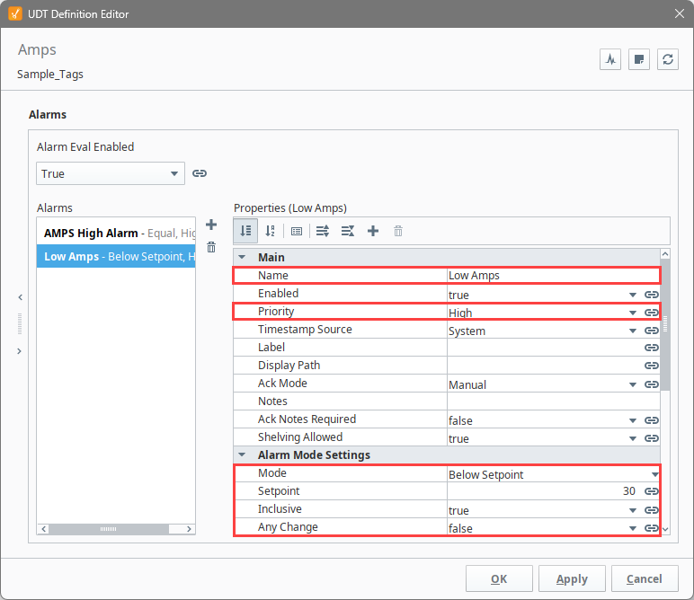

Alarms can be configured on tags inside a UDT so that when you create instances of that UDT, the alarms are automatically applied.
This example configures an alarm on the Amps tag of a Motor UDT that contains Amps.
  1. In the Tag Browser, double-click a UDT to open the Tag Editor.
  2. In the Type Structure area, click a tag.
  3. In the Categories panel, select Alarms.
  4. Click the Add icon.
  5. For this example, configure the following settings:
    • Name: Low Amps
    • Priority: High
    • Mode: Below Setpoint
    • Setpoint: 30
    • Inclusive: true (alarm triggers when the value equals 30 or falls below)
    UDT Definition Editor showing the Low Amps alarm on the Amps tag
  6. Click Apply to save your alarm.
  7. Click OK to save the UDT. Once you create UDT instances, Ignition will start monitoring the alarm immediately.

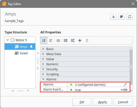

If an alarm in the UDT is updated, instances automatically receive the update. When alarm property values need to be unique for a specific instance, you can override alarm settings. Click the override button on the alarm UI in the Tag Editor (it turns green when active) and edit the properties and their values as needed. For more information, refer to Overriding Properties of the Parent UDT.
Tag Editor showing the alarm icon on the Amps tag of a Motor UDT instance
Configuring Multiple Alarms on a Single Tag​
Tags can have multiple alarms configured, each with unique setpoints and other settings. Adding additional alarms follows the same process as adding the first. Click the Add icon in the alarm UI and configure the new alarm. This allows separate alarms to monitor different thresholds, such as both high and low setpoints on the same tag.

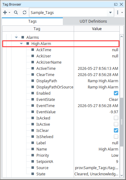

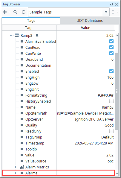

Configured alarms appear under the Alarms node of an alarmed tag in the Tag Browser.
Ramp3 tag expanded in the Tag Browser with the Alarms node highlighted
Expanding an individual alarm reveals its runtime attributes, which are accessible to Tag bindings and scripts.
High Alarm expanded in the Tag Browser showing its runtime attributes

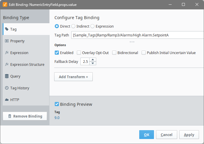

New in 8.1.5
Setpoint and Enabled properties can be modified directly through tag attribute writes at runtime. For example, a Perspective component can bind directly to an alarm's setpoint attribute.
Edit Binding dialog with a Tag binding pointing to an alarm's SetpointA attribute

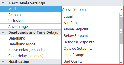

Alarm Modes and Setpoints​
Each alarm is configured with one mode and usually one or more setpoints. The mode determines how alarm activity is evaluated, while setpoints are the thresholds that determine when a tag is in an alarm state. Both work together to control when alarms become active and when they clear.
The available modes can be selected from the Mode dropdown.
Mode dropdown showing the available alarm modes

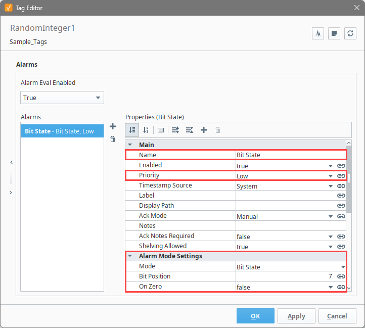

Configuring Alarms on Individual Bits​
  1. In the Tag Browser, double-click your tag to open the Tag Editor. This example uses the RandomInteger1 tag.
  3. Click the Add icon to add a new alarm.
    • Name: Bit State
    • Priority: Low
    • Mode: Bit State
    • Bit Position: 7
    Tag Editor showing a Bit State alarm with the Bit Position set
  6. Repeat steps 3 through 5 for each additional bit, incrementing the Bit Position value as needed.

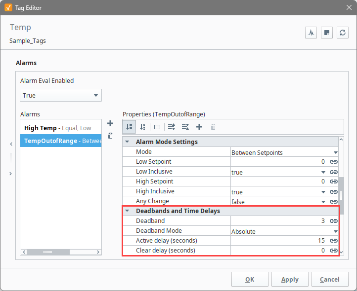

Deadband and Time Delays​
The deadband value is interpreted by the Deadband Mode. All alarms are only evaluated after a tag's value changes, meaning the tag's own deadband is applied first. When the deadband is positive, an active alarm must clear its setpoint(s) by the deadband amount before the alarm transitions to cleared.
For example, a Between Setpoints alarm with a Low Setpoint of 45, a High Setpoint of 65, and a Deadband of 3 becomes active when the value is between 45 and 65, but only clears when the value falls below 42 or rises above 68.
The Active Delay property prevents alarms from triggering until a tag has remained in an alarm state for a set period of time. This is useful when a tag briefly and frequently enters and leaves an alarm state.
Tag Editor showing the Deadbands and Time Delays settings for a Between Setpoints alarm
PropertyDescription
Deadband ModeDetermines how the deadband value is applied.
DeadbandThe amount by which an active alarm condition must clear its setpoint(s) before the alarm transitions to cleared.
Active DelayThe duration a tag must remain in an alarm state before the alarm is triggered.
Clear DelayThe duration a tag must remain in a cleared state before the alarm is marked as cleared.
For more information, refer to the Reference Table on the Tag Alarm Properties page.

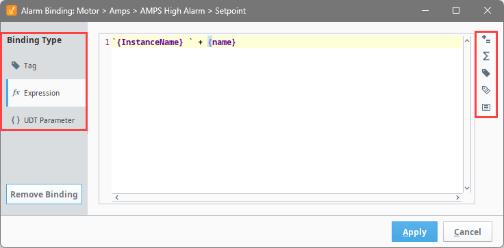

Alarm Property Bindings​
Many alarm properties are bindable and can be bound to other tags in the system, expressions, or UDT parameters. For example, you might bind the Enabled property to a tag representing whether your process is running, thereby disabling the alarm when production is stopped. Or, bind a setpoint to a tag that operators can adjust, allowing the setpoint to change at runtime.
This example shows how to bind an alarm property from the Tag Browser in Perspective.
  1. Double-click a tag to open the Tag Editor.
  2. In the Categories panel, select Alarms. If no alarms exist, first create one using the steps in Configuring an Alarm on a Memory Tag.
  3. Select the alarm. The screen refreshes with all alarm properties.
  4. Find the property you want to bind and click the binding icon to open the binding editor.
  5. Select a binding type from Tag, Expression, or UDT Parameter. The image below shows an Expression binding. The expression can reference the tag's value and other alarm settings. Enter your expression.
    Alarm binding editor with an Expression binding on the Setpoint property
  6. Once the binding is configured, click Apply.
  7. Click OK to save the changes to the tag.

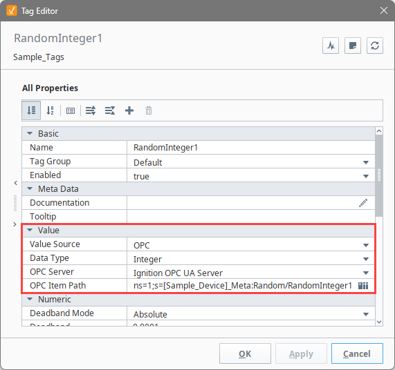

Alarms in Transaction Groups​
Alarms can be added to OPC items in Transaction Groups, allowing alarms to be used without creating a tag in Ignition. An OPC item references a value on an OPC server through its OPC Item Path, the same path used when configuring an OPC tag with OPC as its Value Source.
Tag Editor showing an integer OPC tag with Value Source set to OPC and Data Type set to Integer
In a Transaction Group, selecting an OPC item exposes an Alarming section in the item's properties. Adding and configuring an alarm on the item follows the same steps as adding an alarm to a tag.
