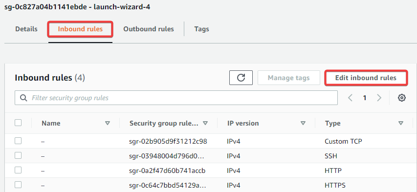

  3. All your available security groups should show up as a list. Click on either the security group ID of the security group you want to modify, or check its checkbox to select it.
    Inbound and Outbound Rules Step 3
  4. You should have a few tabs to select from, including Inbound Rules and Outbound Rules. Click on the tab you want to edit the rules for, and then click on the applicable edit button.
    Inbound and Outbound Rules Step 4
  5. Configure, add, remove, or modify your rules. Once you are finished, click on Save rules.
    Inbound and Outbound Rules Step 5

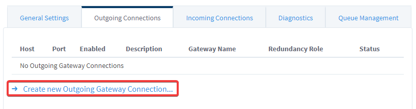

  5. On the Gateway that will be making the outgoing connection, go to the Gateway webpage's Config page > Networking > Gateway Network > Outgoing Connections > Create new Outgoing Gateway Connection...
    Creating a Gateway Network Step 5
  6. Fill out the Gateway Network Settings page using the information you gathered from your AWS instance, then click Create New Outgoing Gateway Connection.
