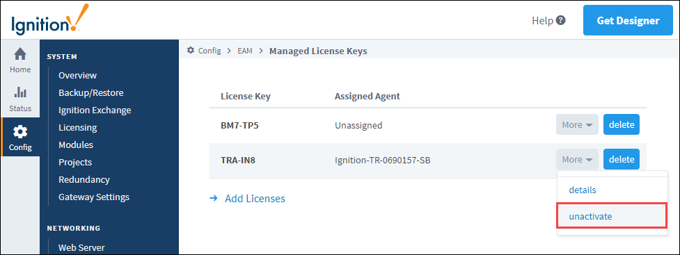

Deleting Licenses​
You can remove unused licenses from the License Management page, but only if the license is not currently assigned to any agent. If you want to delete an assigned license, click the unactivate link on the right side of the license. After the Assigned Agent field changes to “Unassigned,” you can delete the license.
