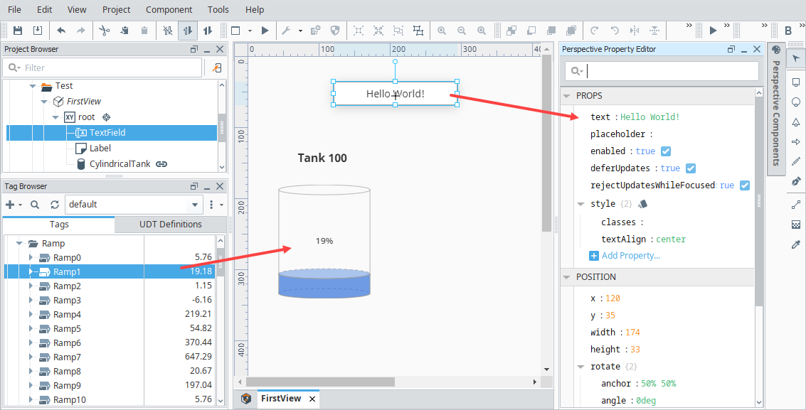

  3. The Designer will refresh and now you're ready to begin adding components into your view. On the right side of the Designer, click on the grayed out Perspective Components banner to open the Components Palette. Drag the Text Field, Label, and Cylindrical Tank components into the View.
  4. To add Tag values to each of the components, click on the component and enter the value in the Perspective Property Editor, or drag a Tag to the value property.
    1. Cylindrical Tank: Drag a Tag from your Tag Browser on to the value property. This example uses a Ramp1 tag.
    2. Label: Enter Tank 100 next in the Text property field.
    3. Text Field: Enter Hello World! in the Text property field. While the component is selected, you can also click and drag the arrow handles to resize them and move them in the Designer workspace.
