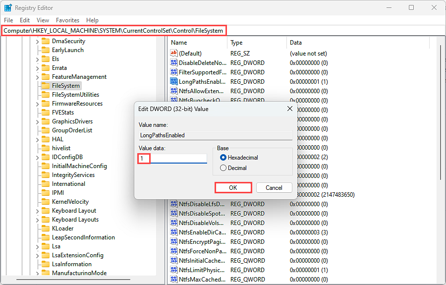

LongPathsEnabled Key​
To help mitigate this limitation, you can open the Windows Registry Editor and set the LongPathsEnabled key to 1, which will remove the Windows API 255 character restriction. This key is located within the Computer\HKEY_LOCAL_MACHINE\SYSTEM\CurrentControlSet\Control\FileSystem folder.
caution
Be aware that even with the LongPathsEnabled registry setting enabled, file management tools may still run into issues.
