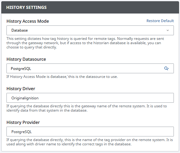

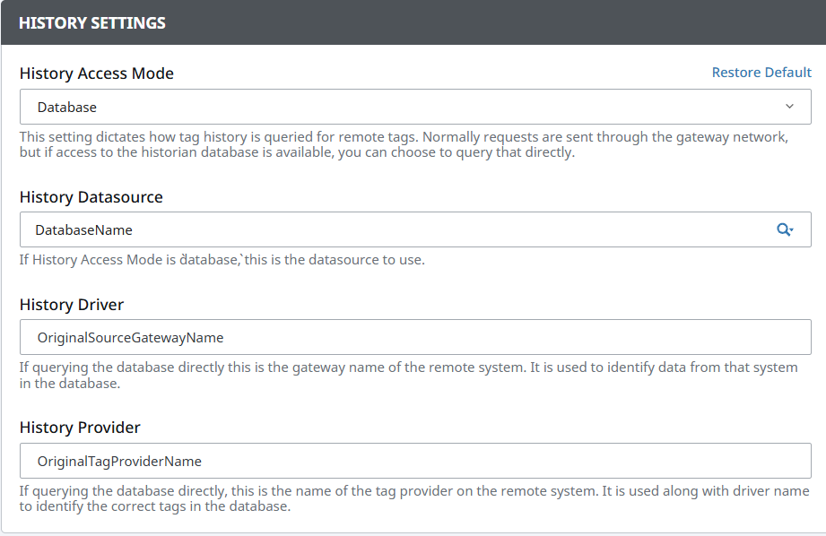

  7. On the Front-End server, create Remote Tag Providers that correspond with the Back-End’s Realtime Tag Providers.
    1. Match the tags by name so that migrated projects can continue to work without changing any Tag Provider references.
    2. Set Alarm Mode to Subscribe.
    3. Depending on your database exposure and tag history usage, ensure the History Settings are configured appropriately.
    4. See Step 9 regarding Service Security if tags are not visible/writeable.

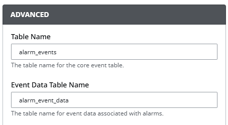

    • This will require your Front-End server to have access to the same database tables, which can be accomplished using one of two methods.
      • The more optimal approach is to allow the Front-End Gateway to create a direct connection to the Back-End’s same database.
      • A Remote Alarm Journal can be created which will query alarm journal events over the Gateway Network.
    • When creating an Alarm Journal profile on the Front-End, ensure the profile name is the same as the Back-End.
    • When creating an Alarm Journal profile on the Front-End that will access the Back-End’s database directly, ensure both Table Name and Event Data Table Name defined in the advanced properties match the name of any existing Alarm Journal Tables.

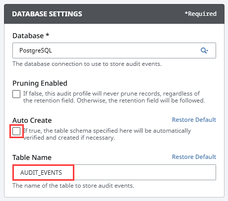

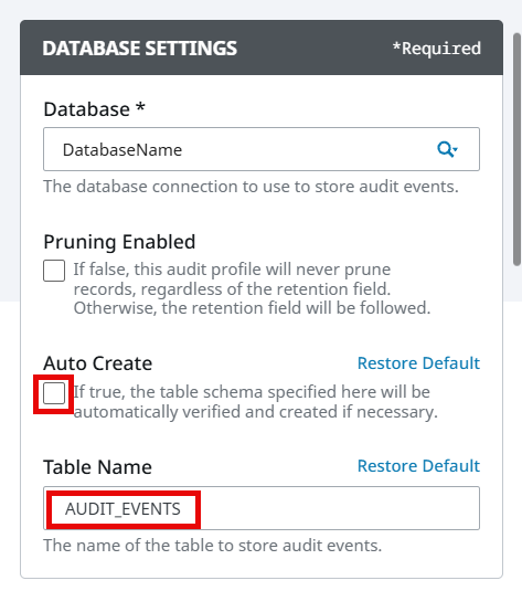

    • This will require your Front-End server to have access to the same database tables but it can be accomplished using one of two methods
      • The optimal approach is to allow the Front-End Gateway to create a direct connection to the Back-End’s same database.
      • A second option is to create a Remote Audit Profile which will query audit events over the Gateway Network.
    • When creating an Audit profile on the Front-End, ensure the profile name is the same as the Back-End.
    • When creating an Audit profile on the Front-End that will access the Back-End’s database directly, set the Auto Create setting to false and ensure the Table Name property defined in the Database Settings matches the name of an existing audit table.

    • To display tag history, your Front-End server needs access to the data. This is accomplished through the Remote Tag Provider's History Access Mode. History Access Mode is set to Gateway Network or Database.
      • Gateway Network: Tag History Bindings will request data over the Gateway Network connection.
      • Database: Tag History Bindings will request data directly from a database. The Front-End server will need a Database Connection created to the same database being utilized for the Back-End server’s Tag Historian for this Tag Provider. Because only a single History Datasource can be specified for the Remote Tag Provider, the Back-End server’s Tag Provider should not have tags using various History Storage Providers. If multiple Storage Providers are used, the tags should be grouped and moved to separate Tag Providers on the Back-End server. Corresponding Front-End Remote Tag Providers can then be created and configured with corresponding History Datasources.
    • Setting the Historical Access Mode to Database provides a more direct line of communication for sending queries compared to Gateway Network; however, all historical tags being referenced on Front-End component bindings may need to be changed to historical tag paths since realtime tag paths are used by default.
      • Historical data will not appear in the result of your queries if tag history bindings are using realtime tag paths against Remote Tag Providers. When Remote Tag Providers are configured to query from a database connection directly, only full historical tag paths provide the information they need to properly locate tag history.
      • In order to check for realtime tag paths in your tag history queries, check the tag path properties for any tag history configurations. If the tag path is structured to resemble a path within a Tag Provider, it is a realtime tag path. For example, [Sample_Tags]Random/RandomInteger1].
    • Historical binding configurations provide browsing for historical tags. If a tag has been storing historical data, expand the browsing folders to locate the proper historical tag path equivalent. You will be able to see this by searching for paths starting with:
      • A Historian name
      • The original Gateway the tag resides in
      • The original Tag Provider the tag resides in. For example, [HistorianName/originalsourcegatewayname:originaltagprovidername]random/randominteger1] is a historical tag path.
    • If Historical Access Mode is set to Gateway Network, realtime tag paths are allowed and bindings will not require any modification, however, tag history queries will need to share resources with other requests being sent through a Gateway Network connection.
