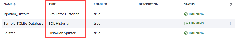

Two aspects to check in your tag history query process are whether you’re using fully qualified historical tag paths and querying history directly against an SQL database for maximum performance. Since tag history can be queried from multiple sources, it’s important to be aware of where tag history is queried from. Tag history queries can be slow, which may increase load on the receiving side and cause bottlenecks on the Gateway Network. Since historical tags use fully qualified historical tag paths, they display provider information. However, realtime tags do not specify which history provider to query from, and therefore may be querying through the Gateway Network without your control.
You can check provider information displayed on the Services > Historians page to confirm the provider Type and make sure you’re querying through your desired location.
The above image also shows there is an option to incorporate a splitter, which allows you to create a database to mirror data so that it can be queried locally. Using a splitter means the data is available on both sides. This enables a faster response time and eliminates a potential need to control who has access on either side. For instance, you will not need to worry about users on a corporate server putting additional load on the Network outside of standard operation needs.

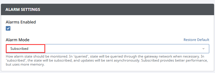

Remote Tag Provider Alarm Subscription​
Remote tags are a very efficient service by default, but can be more useful if you adjust the Alarm Mode for systems split between Back-End and Front-End servers. Alarms should already be visible on the Back-End and are queried by default. Selecting Subscribed for the Alarm Mode pushes alarm notifications immediately on the Front-End server.
This is a manual selection because depending on the amount of alarms, it could cause a delay due to the higher memory use. You must first determine whether subscription benefits outweigh the added load on the Gateway Network. Although the delay will be relatively short, it may cause confusion to an operator or other Front-End user.

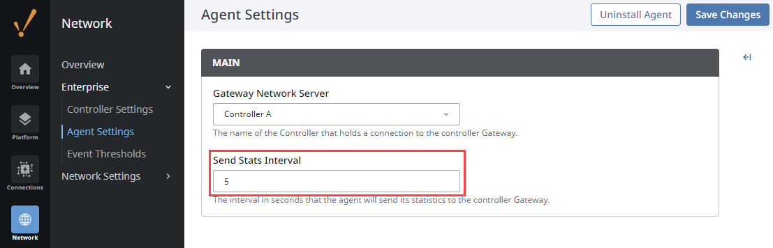

Enterprise Administration Module (EAM)​
All agents configured to the central EAM controller send diagnostic data based on a set interval. If you have a high number of servers in your Gateway Network, you’ll have a high throughput of requests. To counteract this, you can lower the interval to better control queues and optimize overall function. This interval can be modified in the Agent Settings by accessing the agent under the Network section on the Gateway Webpage and selecting Enterprise > Agent Settings. Here you can adjust the Send Stats Interval to a lower number to send statistics less often.

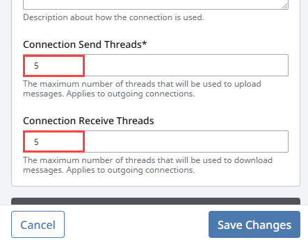

A great way to understand your system’s data flow is to closely review your Gateway Network System Performance page, checking queues and thread pools. Queue statuses can illuminate issues with large numbers of alarms or tag history queries you might not be expecting to see. Maxed out thread pools or a high number of active and pending requests in the queues can unnecessarily slow performance.
Once a thread pool maximum number of requests is reached, the local server will be unable to respond to anything else until those are processed. By default, thread pools have a limit of 5 requests. The maximum limit can be adjusted for different workloads in the Connection Send Threads and Connection Receive Threads settings on the Network > Gateway Network > Connections > Outgoing Connections page by expanding the three dots menu and selecting Edit for the connection that needs adjusting. Although you don’t want infinite threads, which can cause a crash, you can raise or lower this limit to clean up your system. For example, if there are a lot of expected requests for tag history, increasing the limit will reduce issues the local server may experience.

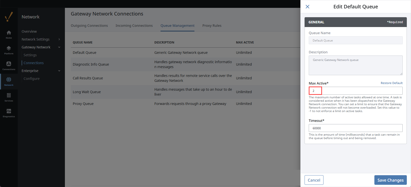

Also, if you are querying tag history though the Gateway Network, adjusting the Max Active number for the Queue Management settings may help avoid bottlenecks or system shutdowns. Navigate to Network > Gateway Network > Connections and select the Queue Management tab to change the Max Active amount from unlimited to a number that best suits your system. Again, you'll need to expand the three dots menu and select Edit to adjust the settings.
Note this may cause errors on the Front-End in the same way as the maximum limit in a thread pool prevents the local system from processing other requests, reaching the Max Active task limit will appear as an error.

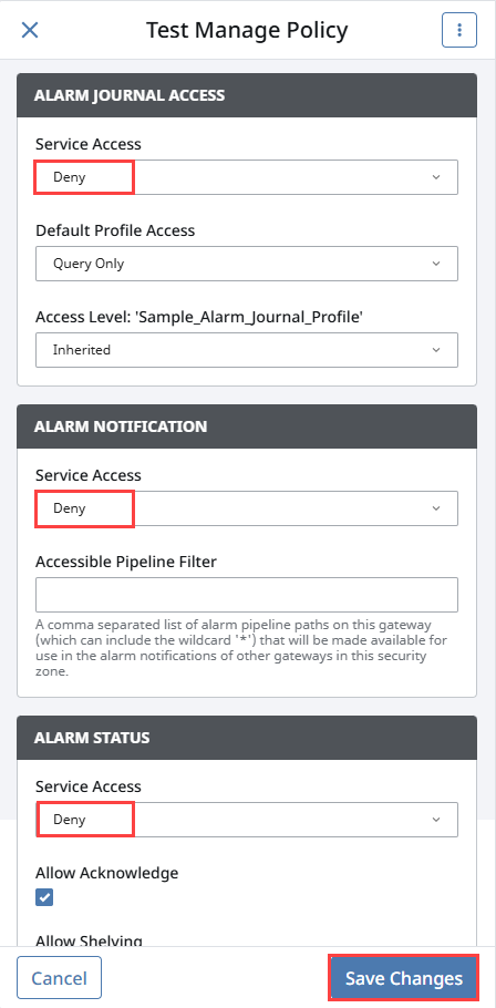

Service Security​
Service Security defines the security policies established at the source for what data is accessible. It can define if a specific service is available at all, read-only, read-write, and so forth regardless of connection direction. Zero-trust is not the default security policy, but it should be highly considered since being strict about security is the best way to control the flow of data. A zero-trust policy will reject all unwanted requests. To update your Default policy to zero-trust, navigate to Platform > Security > Zones and click on Manage Policy within the three dots menu for your security zone. Use the Service Access dropdown on each Alarm section to select Deny, then click Save Changes when finished.
Now, you can define new security zones and edit zone-based settings as needed for your system to allow wanted requests. See the Tag Access image below for an example.
  1. Navigate to Platform > Security > Zones and select Create Security Zone.
  2. Enter a zone name and fill in any of the three Identifier fields to add services to the zone.
  3. Click Create Security Zone and see your new zone listed on the page.
  4. Expand the three dots menu for your policy and select Edit to choose what fields you want to enable and how.
