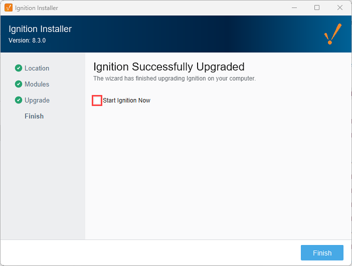

Installation B​
  1. Install Ignition 8.3 on the second machine, but DO NOT start the service. To install without starting the service, uncheck the Start Ignition Now option during installation.
  2. Delete the existing data directory:
    • Windows: C:\Program Files\Inductive Automation\Ignition
    • Linux: /usr/local/bin/ignition
    • Mac: /usr/local/ignition
    cd <ignition-install-directory>
    rm -rf data
  3. Clone the repository data directory as the data directory:
    git clone <your-repository-url> data
  4. Start the Ignition service:
    ./ignition.sh start or ./start-ignition.bat

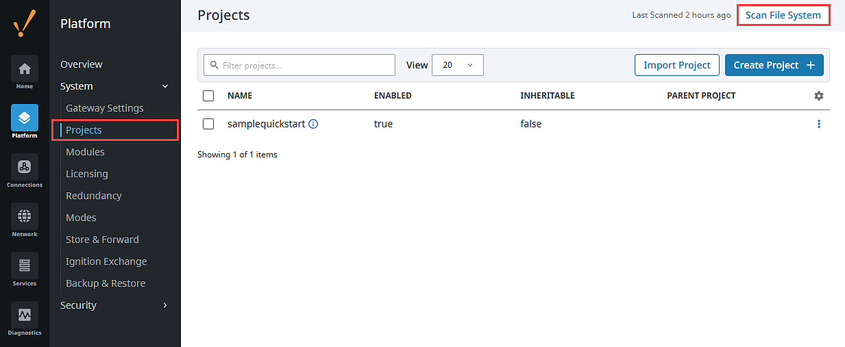

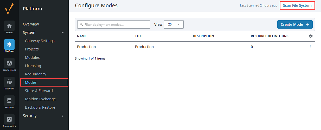

Pulling Changes (Installation B)​
  1. Pull latest changes:
    cd <ignition-install-directory>/data
    git pull origin main
  2. Trigger scans to apply changes on the Gateway using Scan File System, located in the top right corner of the following screens.
    • To scan the config files, navigate to Platform > System > Modes.
    • To scan the project files, navigate to Platform > System > Projects.
    tip
    File system scans can alternatively be performed using the following API endpoints:
    • <ip>:<port>/data/api/v1/scan/config
    • <ip>:<port>/data/api/v1/scan/projects
    Refer to the API Documentation to learn more about how to access and use the Gateway API.
