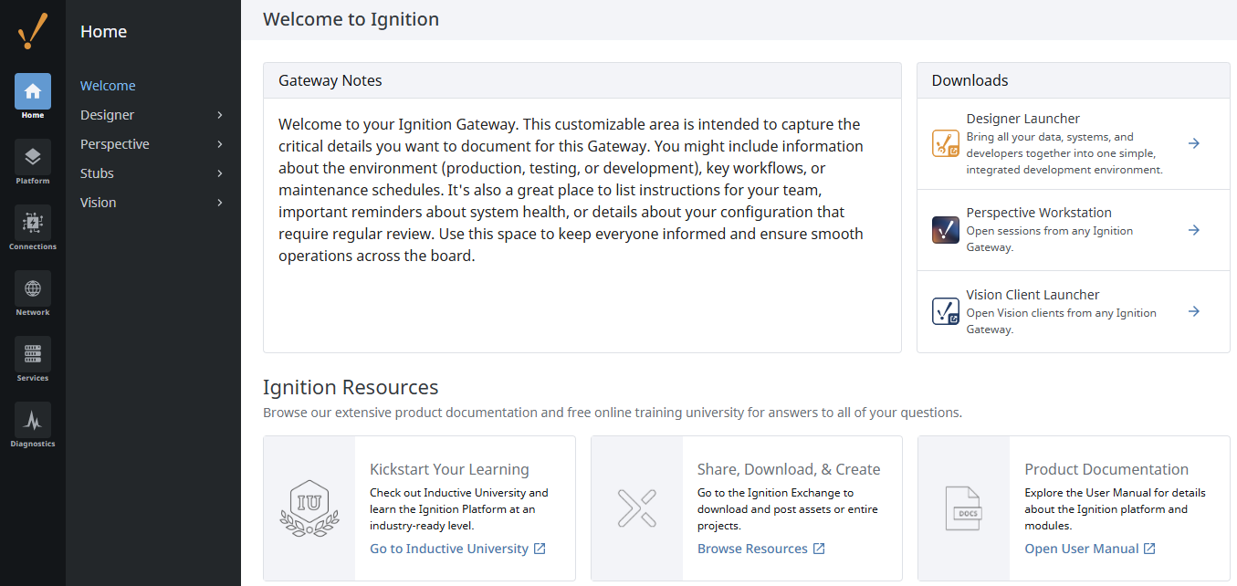

  11. Once Ignition is installed, your default web browser will open and you will be greeted with a Welcome to Ignition. You will be presented with a message to select a version to install. Select Ignition.

That’s it. Your Ignition installation is complete and the Gateway is launched. Your web browser opens the Gateway Welcome page at http://localhost:8088. Sign in using the credentials for the user you created in Step 13.
