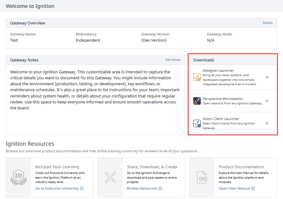

  2. Open up a web browser and go to the Gateway's webpage: http://localhost:8088. If the Gateway is installed on a different server/computer, then you'll need to know the IP address or host name. Example: http://ipaddress:8088.
    note
    The first time you go to the Gateway webpage, it shows you the links to download the Designer, Vision Client Launcher, and Perspective Workstation.
  3. To navigate back to the Gateway Welcome page, click the Home tab.
