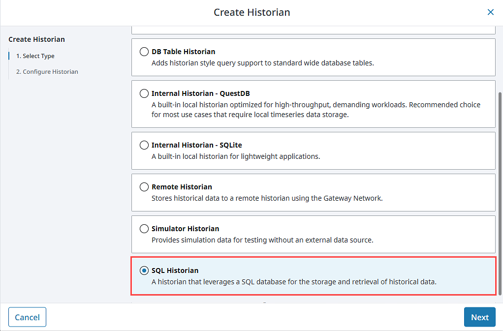

When you have both the Historian Core module and SQL Historian module installed, you simply need to navigate to Services > Historians > Historians and select Create Historian to add a SQL Historian to your Gateway. From here you can choose where to store your tag history, and configure data partitioning and data pruning settings.
