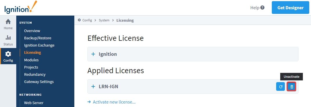

  1. Unactivate your license key from your old Gateway by going to the Config section > System > Licensing. You will be able to see any licenses that are currently applied.
  2. Click the Unactivate button (trash can icon) under Applied Licenses.
    Part 1a Online Unactivation Step 2

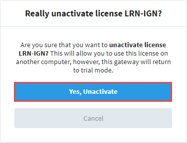

  3. A confirmation window will appear, asking you to confirm the unactivation. Click the Yes, Unactivate button. It may take a minute or so for the request to finish.
    Part 1a Online Unactivation Step 3
  4. The unactivation request will be sent to Inductive Automation's licensing servers, and the license will again be available for activation on another Gateway.
    Part 1b Offline Unactivation Step 3

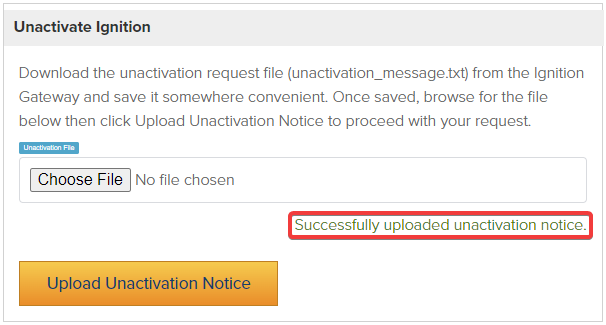

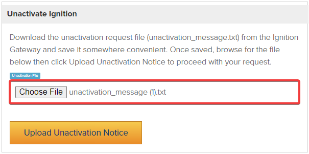

  5. Take the unactivation_message.txt file to a machine with Internet access and go to https://links.inductiveautomation.com/activation.
  6. Click Choose File and select the unactivation_message.txt file.
    Part 1b Offline Unactivation Step 6
  7. You will see a visual confirmation that your unactivation_message.txt file has been successfully uploaded, and the license key can now be activated on a different Gateway.

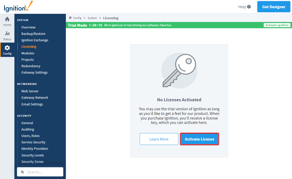

  1. Go to the Gateway webpage and select the Config section.
  2. From the menu on the left, select System > Licensing. The Licensing page will appear, from which you will need to click Activate License.
    Part 2a Online Activation Step 2

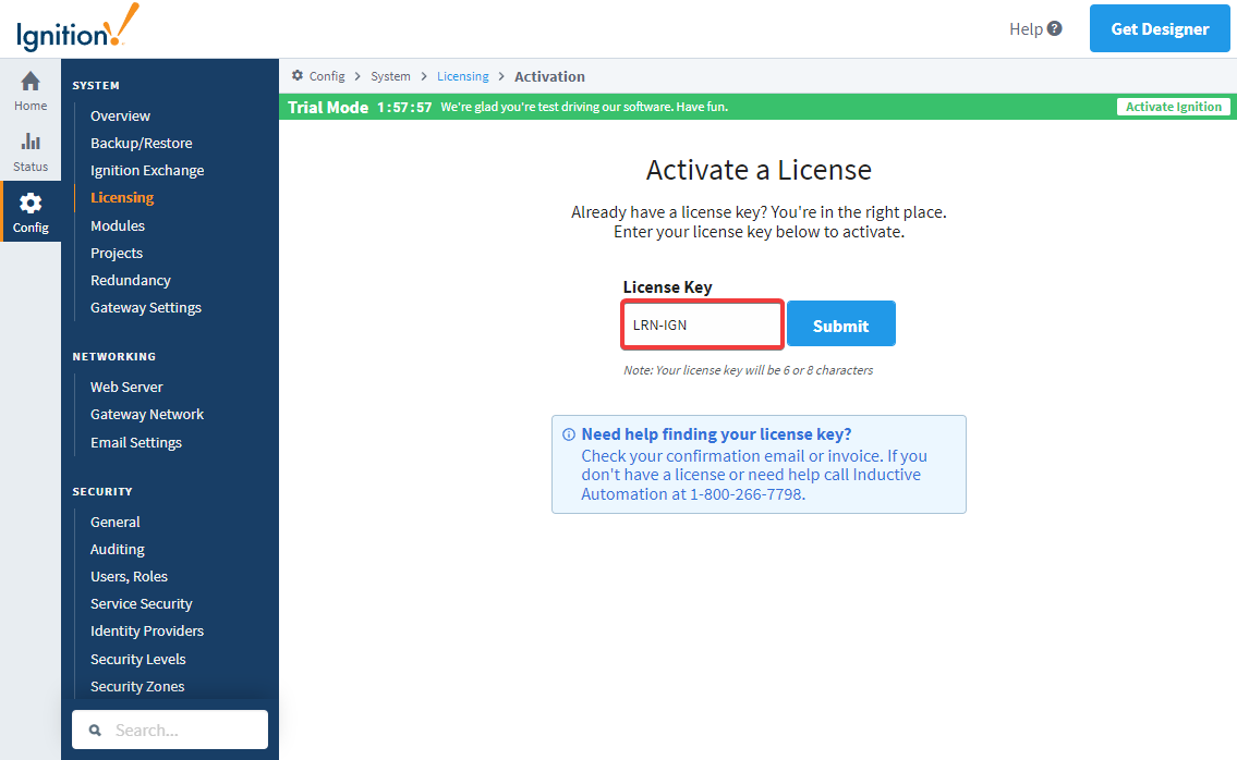

  3. The Activate a License page will be shown. Enter the license key from the old Gateway and click Submit.
    Part 2a Online Activation Step 3

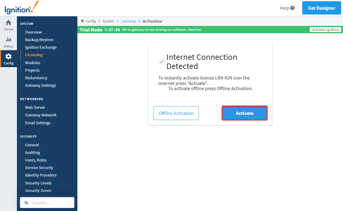

  4. If you are connected to the Internet, click the Activate button.
    Part 2a Online Activation Step 4

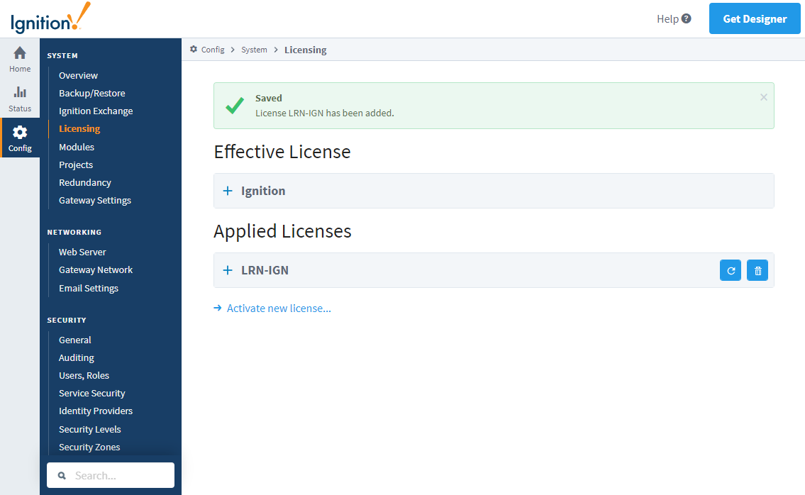

  5. The Licensing page will refresh, and your license key will be successfully activated.
    Part 2a Online Activation Step 5

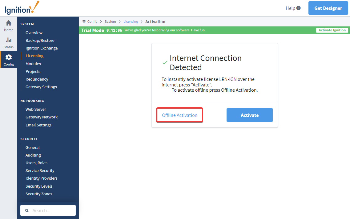

  4. If you are not connected to the Internet, or if you want to activate your Gateway manually, click the Offline Activation button.
    Part 2b Offline Activation Step 4

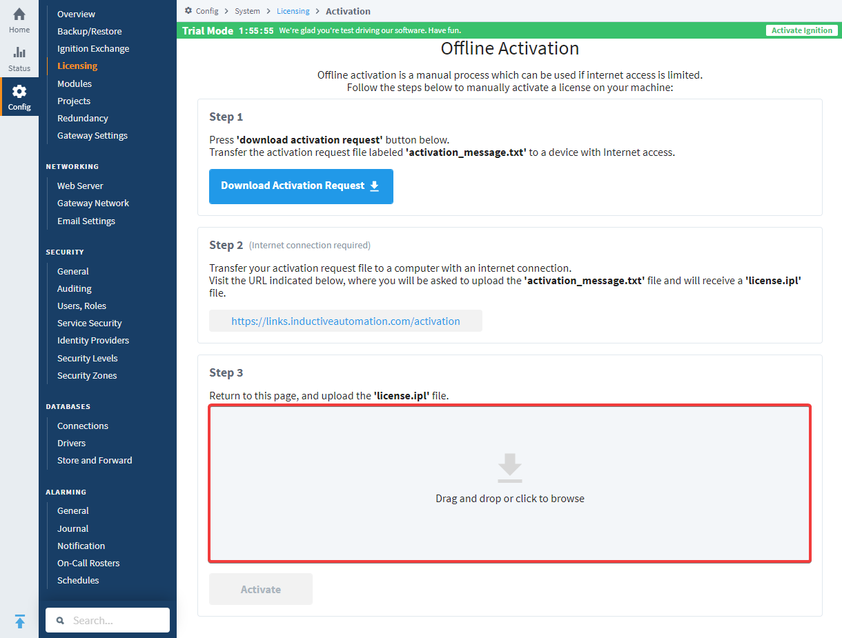

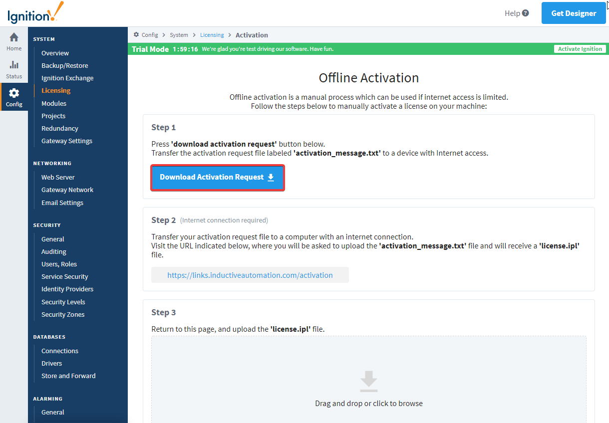

  5. Click the Download Activation Request button. An activation request file, called activation_message.txt will be generated and downloaded.
    Part 2b Offline Activation Step 5

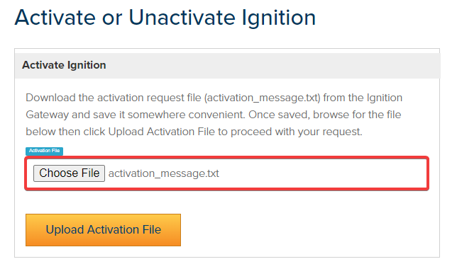

  6. Take the activation_message.txt file to a machine with Internet access and go to https://links.inductiveautomation.com/activation.
  7. Click Choose File and select the activation_message.txt file in the Activate Ignition section.
    Part 2b Offline Activation Step 7
    note
    Should any trouble occur with the upload process, please contact our Support department.
  8. Once you upload the activation_message.txt file, a license file called license.ipl is generated.
  9. Bring the license.ipl file back to the computer on which you're licensing Ignition. Back on the Offline Activation page, upload the license.ipl file. Then, click Activate to finish the process.
