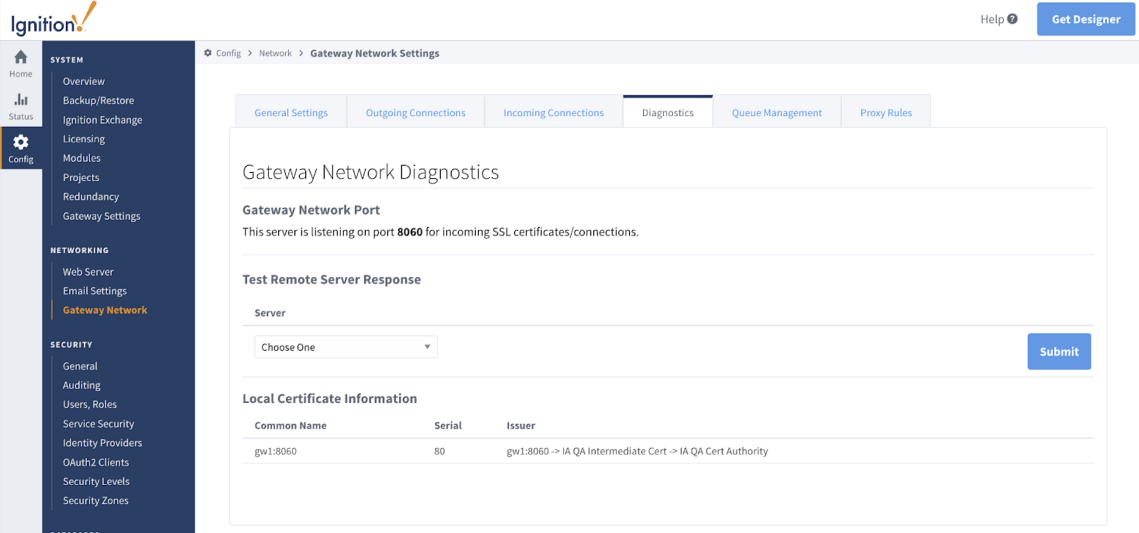

Once all certificates are signed and configuration is complete, you can restart your Gateway and then navigate to Config > Gateway Network to access the Diagnostics tab and confirm the local certificate information.
Local Certificate Information
