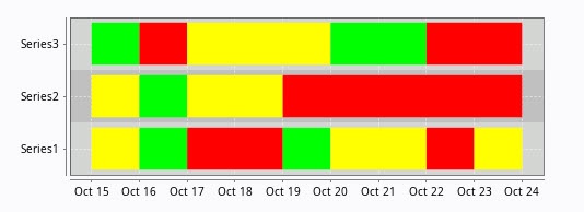

This example uses the Status Chart to display the state of each of the three machines over consecutive days using the Muli-State button. Tag History was turned on to record history HOA values. The Series Data property's dataset populates the Status Chart using a Tag History Binding. You can view the raw data by clicking on the Dataset Viewer icon to the right of the Series Data property. Each color represents a state for the machine and can be set in the Series Properties Data property. This example also has the raw data in the code block in case you want to try it for yourself.
Series Data - Dataset Viewerβ
"#NAMES"
"Timestamp","Machine 3","Machine 2","Machine 1"
"#TYPES"
"date","I","I","I"
"#ROWS","10"
"2008-10-15 00:00:00.000","0","0","1"
"2008-10-16 00:00:00.000","2","2","1"
"2008-10-17 00:00:00.000","0","0","0"
"2008-10-18 00:00:00.000","1","1","1"
"2008-10-19 00:00:00.000","0","0","2"
"2008-10-20 00:00:00.000","0","1","2"
"2008-10-21 00:00:00.000","0","0","1"
"2008-10-22 00:00:00.000","1","2","1"
"2008-10-23 00:00:00.000","0","1","1"
"2008-10-24 00:00:00.000","0","0","1"
Series Properties Data - Dataset Viewerβ
Each machine has three states, and each of the three states (i.e., HOA) have different colors assigned representing a different state.
