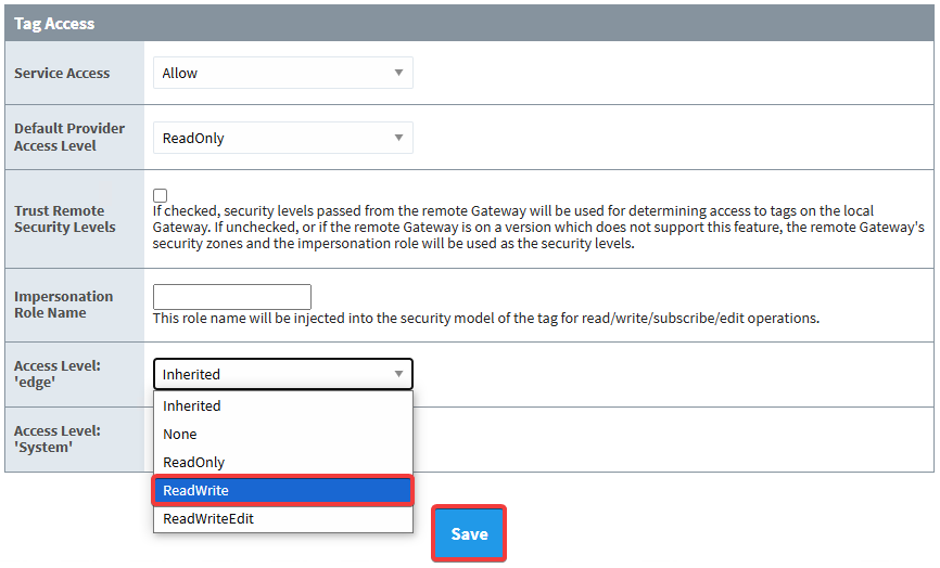

Now that you’ve created your remote Tag Provider, you can access your central Gateway’s Designer and see your new remote Tag Provider. You can read your tags, but still need to configure security before you can write to them. If you try to write at this point, an error message will appear because the default security zone settings restrict write access to these tags.
To configure system security to allow writing to tags:
On the Edge Gateway, navigate to Config > Security > Service Security.
Click Edit for Edge Gateway's Security Zone.
cautionAfter policies are defined on at least two zones, you'll notice Move Down and Move Up button options are displayed. Use these as needed to make sure your Security Zones are listed in the correct order. If your incoming connection falls into multiple security zones, the one it falls into first is the one that will be used.
Scroll down to the Tag Access section to change your Access Level setting to Read/Write.
Locate the Access Level setting for your Edge Tag Provider and use the dropdown to select ReadWrite.
noteIf you want to enable ReadWrite access for all tags in this security zone, you can select ReadWrite for the Default Provider Access Level setting.
Click Save.
With the changes to the security zone in place, you can now write to the tags without an error message and any values entered into the tag on your central Gateway will update in the actual Tag Provider on your Edge Gateway. Follow this same procedure and select ReadWriteEdit to allow tags to be edited from a remote Designer.
