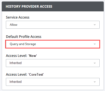

Before data can be synchronized across Gateways, your standard Gateway's system must be configured to accept Edge storage. This can be completed by navigating to the Platform > Security > Zones page and accessing the Manage Policy panel for the security zone you want to use for Edge storage. This is done by expanding the security zone's three dots menu and selecting Manage Policy. Afterwards, you can select Query and Storage for each section you will be receiving data from. Available sections include Alarm Journal Access, Audit Log Access, and History Provider Access.
Once you've allowed storage access, you can navigate back to your Edge Gateway to finish configuring your synchronization settings under Platform > System > Ignition Edge > Sync Services page.

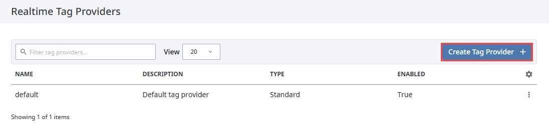

  1. Navigate on your central Gateway Services > Tags.
  2. Click Create Tag Provider +.

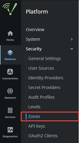

  1. On the Edge Gateway, navigate to Platform > Security > Zones.

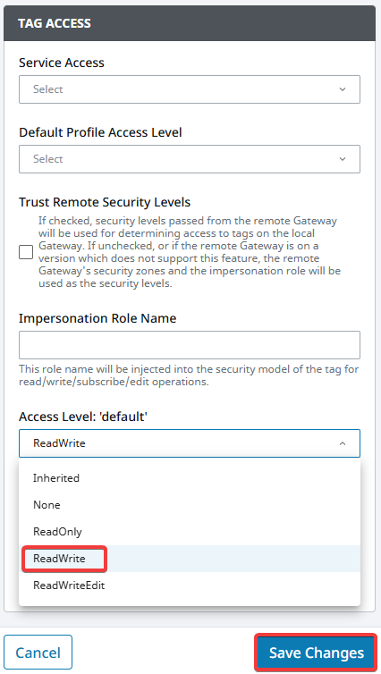

  3. Scroll down to the Tag Access section to change your Access Level setting to Read/Write.
  4. Locate the Access Level setting for your Edge Tag Provider and use the dropdown to select ReadWrite.
    note
    If you want to enable ReadWrite access for all tags in this security zone, you can select ReadWrite for the Default Provider Access Level setting.
    Edge GW Remote Tag Read Write Access Level
  5. Click Save Changes.
