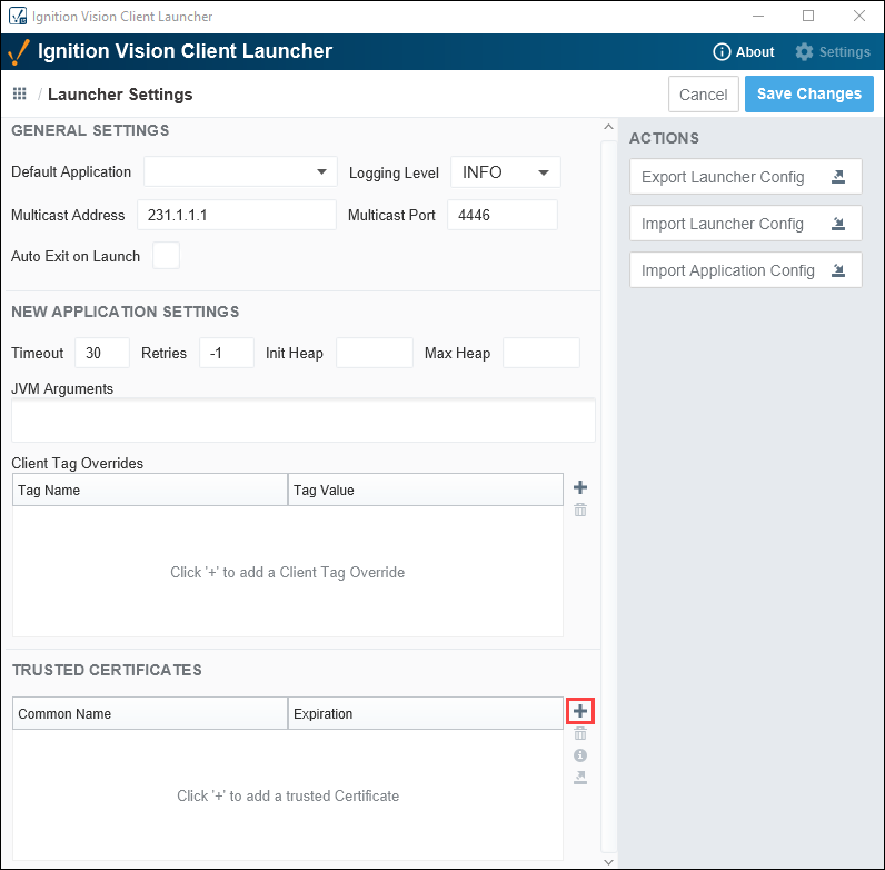

You can find the Settings button in the upper right corner of the Vision Client Launcher.
You can choose to use the default settings or customize your Client applications. There are three different Actions in Settings in the Vision Client Launcher:
  • Export Launcher Config: Exports a configuration of the the Vision Client Launcher, as a JSON file (i.e., vision-client-launcher.json). Taking an export is useful in cases where you want multiple launcher instances to use the same settings. The content of the export file is based on the last saved configurations settings of the Launcher.
  • Import Launcher Config: Imports your launcher configurations from a Vision Client Launcher export file.
  • Import Application Config: Creates a new Client application configuration from an export, adding a new application to the Launcher. The import file is the same generated by an application export.
When finished updating any of the Client Launcher settings, click the Save Changes button. Refer to the list of additional launcher settings in the reference table below.

Trusted Certificates​
You can add security certificates to the Launcher.
While attempting to launch an application, the Launcher will check against the application's host Gateway, and attempt to automatically download any required certificates. In addition, certificates can be manually added using the example below.
  1. Access Vision Client Launcher settings by clicking Settings on the top right of the Vision Client Launcher window.
  2. In the Trusted Certificates section, click the Add icon.
  3. Navigate to the location of the certificate on your system and choose Open.
  4. Information about the certificate is displayed. To view complete details, click the Expand icon next to Details. If everything looks OK, click Trust Certificate.
  5. Once a certificate is imported, you can view its details by clicking the Information icon.

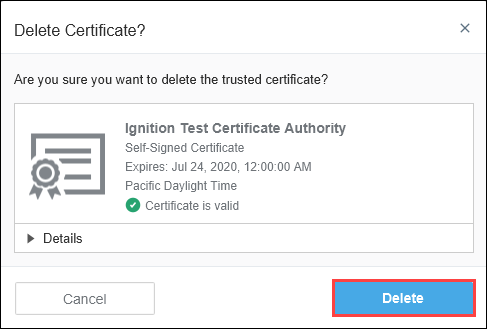

Delete a Certificate​
  1. To delete an imported certificate, access Vision Client Launcher settings by clicking Settings on the top right of any Vision Client Launcher window.
  2. In the Trusted Certificates section, select the certificate you want to delete.
  3. Click the Delete icon.
  4. You'll get a confirmation window. If the certificate is the correct one you want to delete, click the Delete button.
