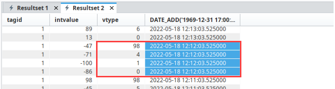

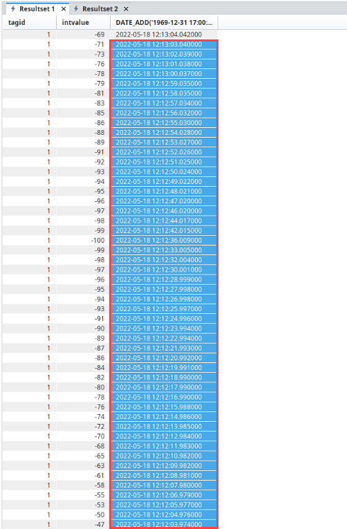

The Resultset 1 table below shows the normal partitions of 50 raw values between a highlighted time block spanning from 12:12:03.52 to 12:13:03.52.
With pre-processed partitions enabled, these 50 rows of data were also summarized into four rows shown on the Resultset2 tab displaying the pre-processed partition values.
You may notice that the pre-processed partition table also includes a vtype column. The vtype represents metadata about the record using the following flags:
- 0: Time-weighted average
- 1: Minimum value
- 2: Maximum value
- 4: Exit value (last in window)
- 32: First value flag (used with min/max to indicate which came first)
- 64: Entry value (first in window)
Each record in the set represents a different value for that 1 minute time window, each value given a different vtype. The first record above has a vtype of 98, which means that this record represents the entry (64), the first value (32), and the max (2) of the records between 12:12:03.52 and 12:13:03.52. The second record value is 4. This value represents the exit value for this same 1-minute time block. The third record value is 1, which represents the min value. Finally, the last record value is 0, which represents the direct average for the original 50 rows.
