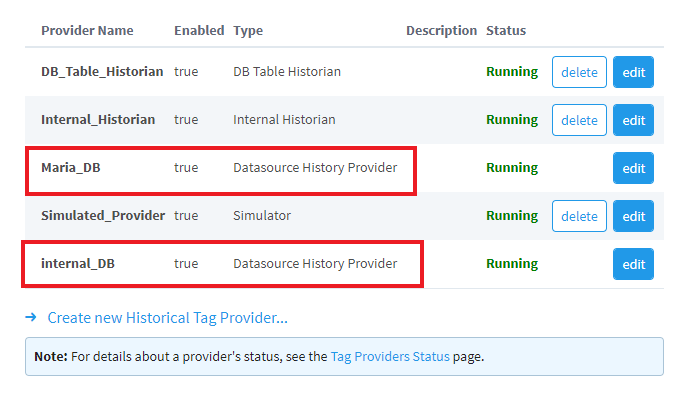

Utilizing this provider requires a Datasource History Provider, which is the type of historical provider that is automatically created whenever a Database connection is configured. You can check the type of any History Provider under the Config section of the Gateway, on the Tags > History page.

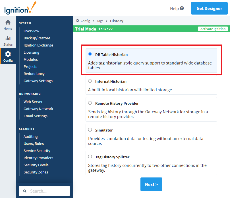

On the Gateway Webpage, navigate to the Config section.
Under the TAGS heading in the sidebar, click on History.
On the History Provider's listing, click Create new Historical Tag Provider.
From the listing of available types, select DB Table Historian, and click Next.

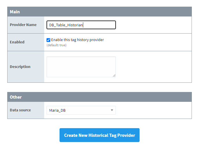

Enter a unique name for the provider in the Provider Name field.
In the Data source field, select the backing data source. You would select which ever Datasource History Provider contains the tables you want exposed to the historian system. Once ready, click the Create New Historical Tag Provider button, which completes the configuration process.

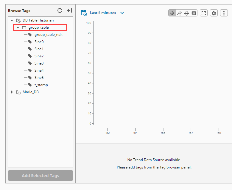

Once configured, the DB Table Historian will expose any tables found in the associated data source (specifically, the Data Source listed on the configuration page of the DB Table Historian). From this point on, any tables found in the data source will be available for browsing via the various Tag History interfaces found throughout Ignition.
For example, we could store some records in a database connection with a Transaction Group, which would create a table like the following:
Then, we could use the Perspective Power Chart built-in Tag browser panel to detect the table, which exposes the columns as "tags":

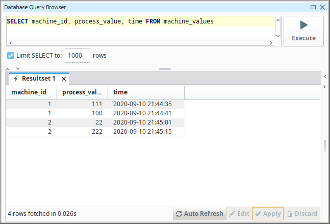

Say we have a database table like the following.
SELECT machine_id, process_value, time FROM machine_values
machine_id | process_value | time |
1 | 111 | 2020-09-10 21:44:35 |
1 | 100 | 2020-09-10 21:44:41 |
2 | 22 | 2020-09-10 21:45:01 |
2 | 222 | 2020-09-10 21:45:15 |

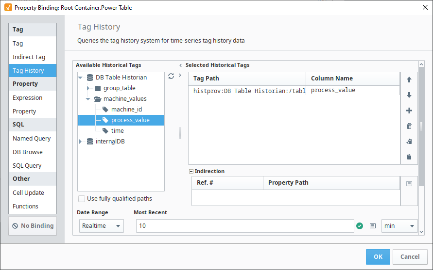

We could use the DB Table Historian provider to expose our machine_values table to a Vision Tag History Binding.
The resulting historical Tag path for process_value (after dragging it over to the Selected Historical Tags table) would look like the following:
histprov:DB Table Historian:/table:machine_values:/column:process_value
We would need to explicitly state that the "time" column should be used by the binding, so we could double click on the cell under the "Tag Path" header, and change the Tag Path to the following, which would allow the query to feature the records accurately.
histprov:DB Table Historian:/table:machine_values:/column:process_value:/timestamp:time
We could further modify this Tag path, so that only entries with a "machine_id" of 1 are returned, but changing the path to the following:
histprov:DB Table_Historian:/table:machine_values:/column:process_value:/timestamp:time:/keycolumn:machine_id:/keyvalue:1
